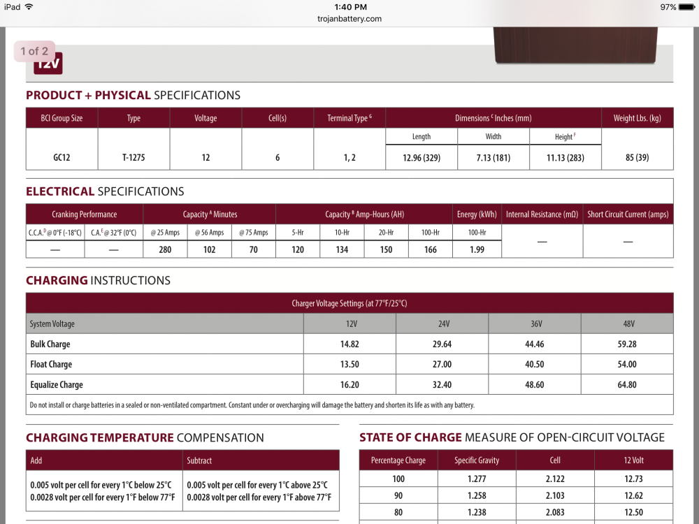

I've got three Trojan t-1275 battery's that I could use for my secondary battery's in the trunk. Would they work? I'm looking to upgrade to a 1500watt rams amp and will need more power than stock. Would these battery's be okay in a trunk
Like the golf cart Trojan batteries? Don't quote me butbi imagine they have a low discharge rating. Something to look into.

Here are the specs on it. Will it work? I just don't know what to look for in a battery
