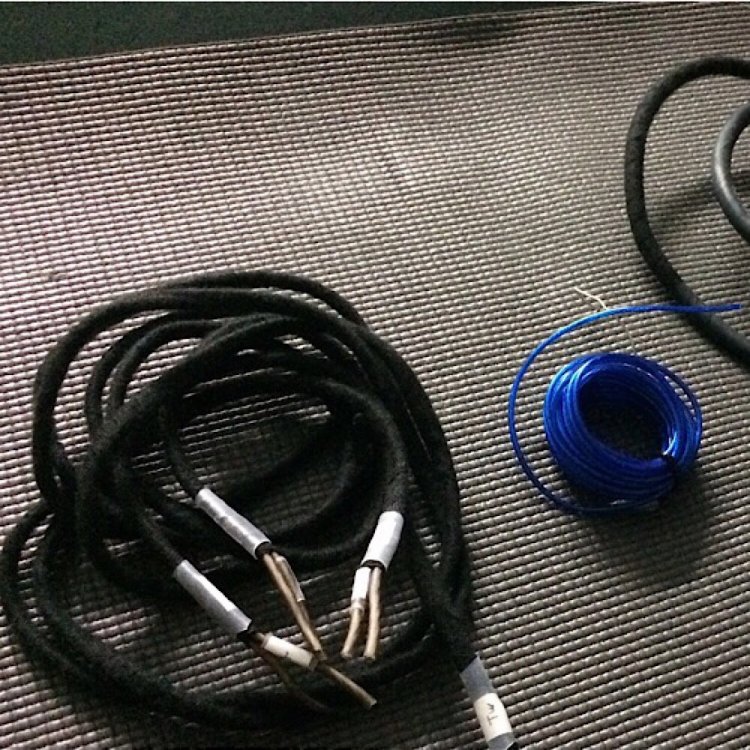

Só My next step was to prep the wiring that I was going to use, at this stage I started to buy Focal 8 GA kit. Later, I realized that this kit had CCA cables and that I could reduce the performance of the Amp.
With the use of the Rockford Fosgate amp wire tool, I also realized that I could increase the amp performance if I went with a 4GA wire kit.

Proceeding with the build, and putting the cables to the trunck I had to take the passengers seat, remove the kick pannel and side panel and power cable going through the fire wall. Here some images.
On the 3th image the B is all the “sound cables”, that is RCAs,Ai-net, and speaker cables and A the power cable coming from the battery.

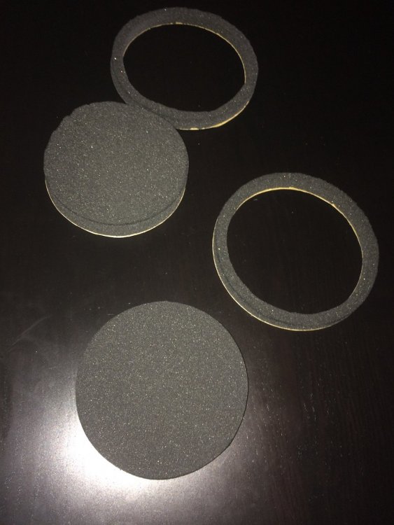

Best option know would probably speak about what did for the front speaker set.
Images 1 to  3 - Equipment used
Image 4 to 5- prep the equipment - from speakers (SPG-10c2) added a cap of 47 uF in parallel with the woofer
Image to 6 to 9 - prep the door - openes air vents for speaker to breath and Stinger Roadkill
Regarding the door pods they are currently on  being covered in leather - will show more details later.
