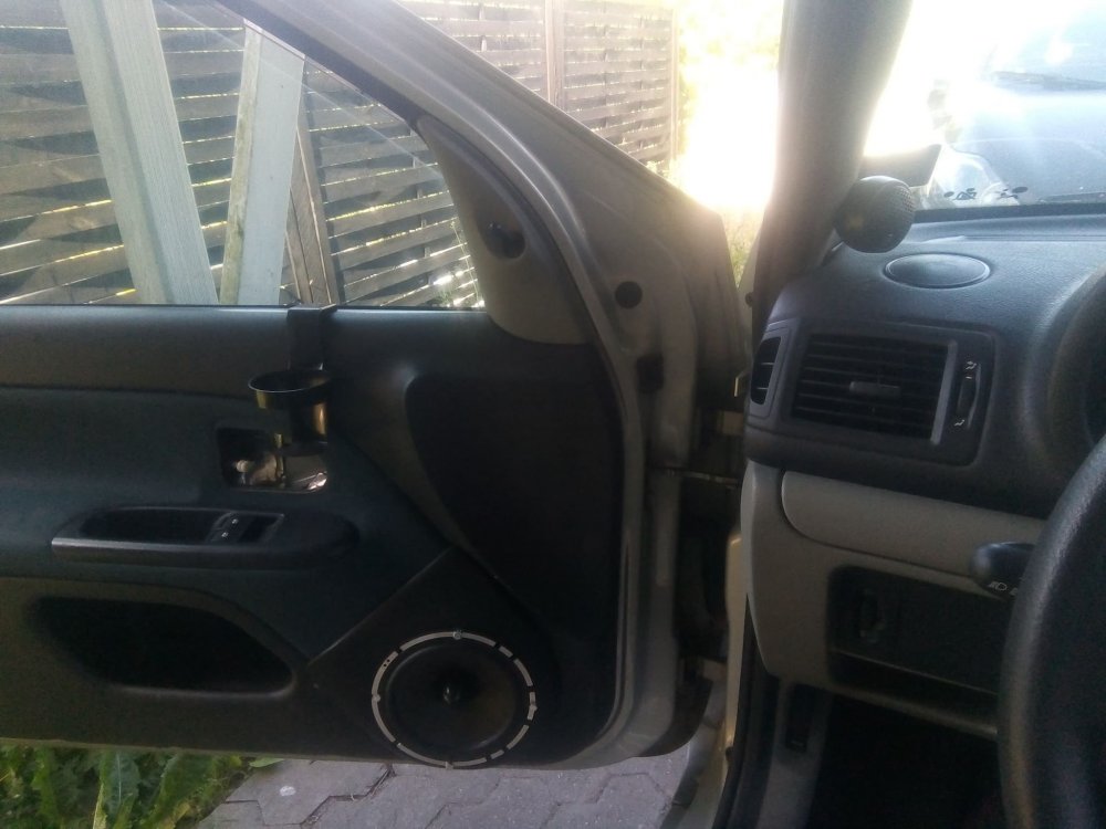

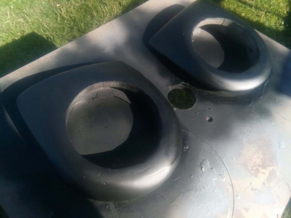

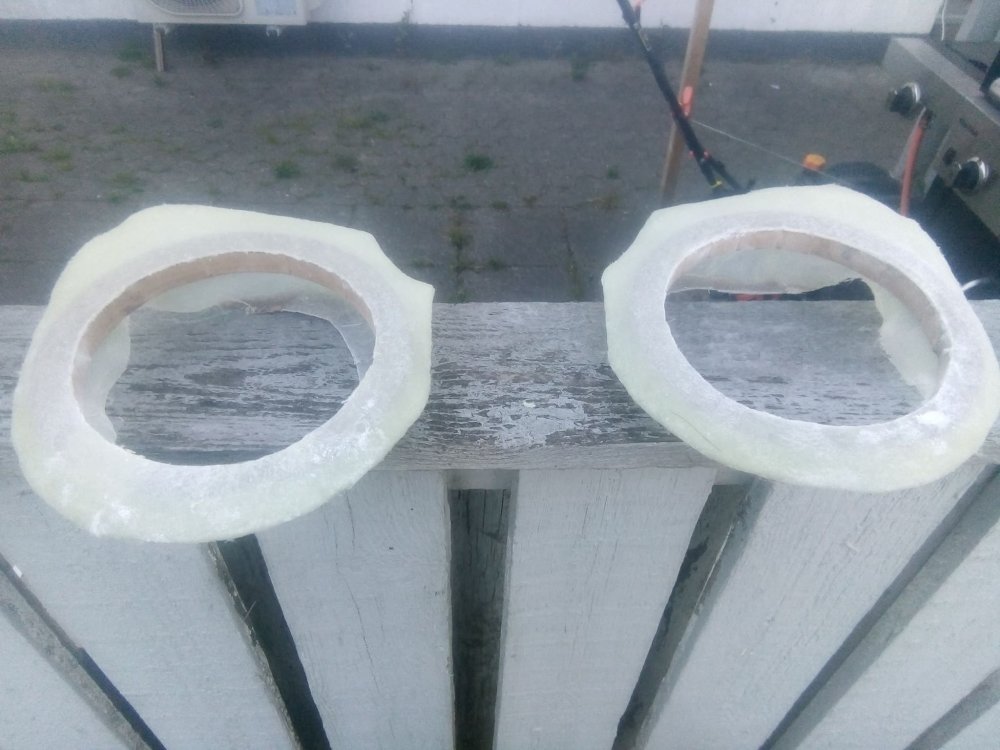

First thing was new door pods..
The Clio only has 5,25 from factory - i wanted 6.5".. the first pair i did (original rebuild) i might burned on a bonfire.. So, now i made these!
I'm not complety happy with them - there is some air bubbles in the filler i could not make go away, so they would be better of wrapping.. I've chose to spray them, so at some point i might redo them..!

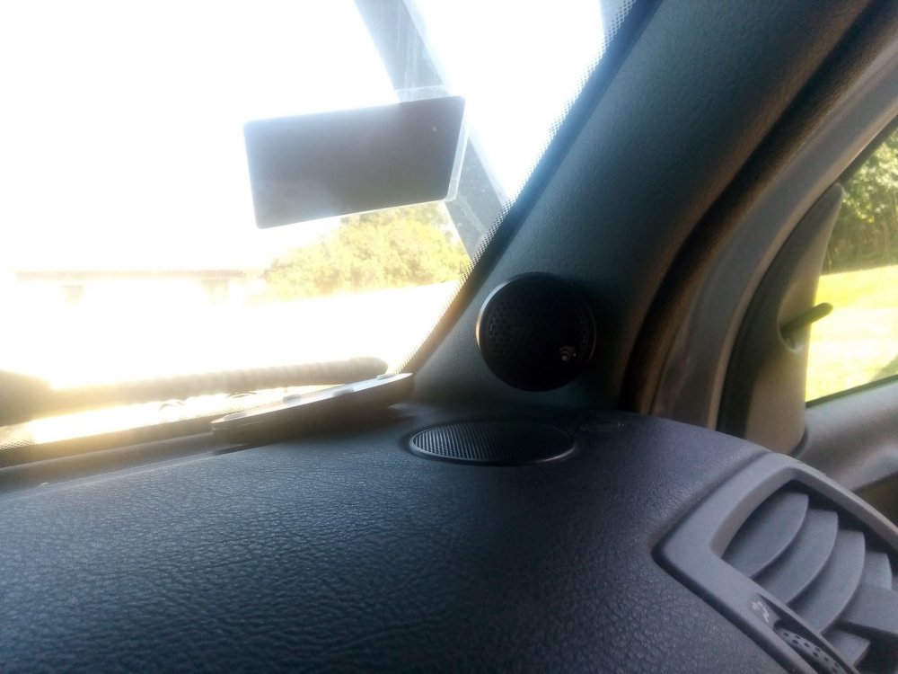

Also did tweeters, did not want to do custom A pillars this time, so they are in the orignal housing..
Last time i did the Massive i did custom a pillars - but the tweeters pointed to much to the middle, making the stage to narrow.. So, now i'm trying to do like this, to see if the stage get as wide as i know is possible.. :)
(Don't talk about the lack of doorhandles, they will go in)
