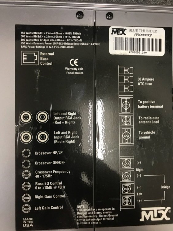

Adrian2898 Posted September 16, 2018 Report Posted September 16, 2018 How are the specs on this amp? I can buy it for $70 , would it be a good purchase? Would I be able to run it at 1 ohm? Thanks and sorry I'm new to the audio world.
SkarredSierra Posted September 16, 2018 Report Posted September 16, 2018 Good amp from wen mtx made solid products. No u cannot run it at 1 ohm. Either 2 or 4 ohms per channel or 4 ohms bridged.
blarg456 Posted September 16, 2018 Report Posted September 16, 2018 I had one of those. Had issues with it overheating if it was installed in a tight spot during the summer heat. As long as you can keep it cool it's a good 2 or 4 ohm amp. I would offer $50
CreepyPancake69 Posted April 5, 2019 Report Posted April 5, 2019 Funny i just replyed to you on YouTube. My amp has same specs but looks alot different. Mine says pro3002 not pro300x2 and is blue powder coated. I’ve bridged 2 1200 jbl gti’s at 2 ohms and has run fine if not at max volume more than 30 min or so. Has never overheated and shut down protect mode.
