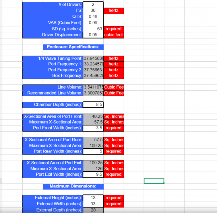

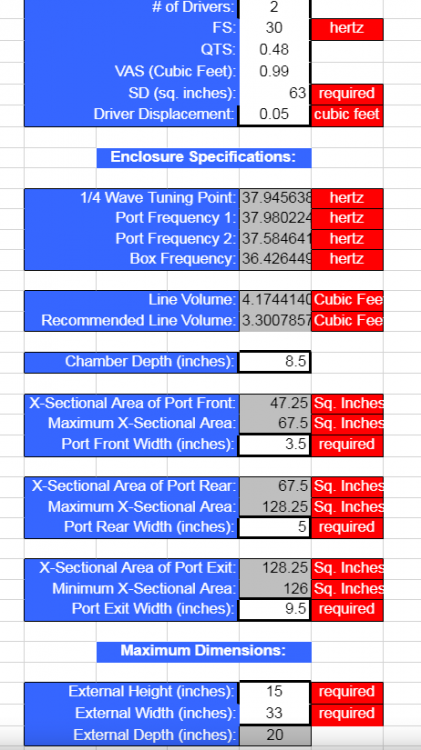

I have a pair of Punch HX2 10's that I am itching to build another box for.  I am going for a musically loud box.  I know everyone wants a musically loud box...
Ive built a T-line for 2 8's before and those hammered in my opinion, a traditional t-line for 2 10's would be way to big, but the 1/4 wave horn is a size I can do.  it would be about 33w x 15h x 20d.  Tuning is around 37-38hz
Then again I am not to sure how much output I would actually be gaining over a traditional ported box.  If I built a ported box it would be significantly smaller, about 2.75 cu ft with a 6 in aero.  tuning would be at 35hz.
This is going in an 2017 Civic coupe, either in the backseat or in the trunk on ~1000 rms. I heard putting subs in the backseat was worse compared to in the trunk because of cancelation, but I hate hearing trunk rattle.  Opinions?

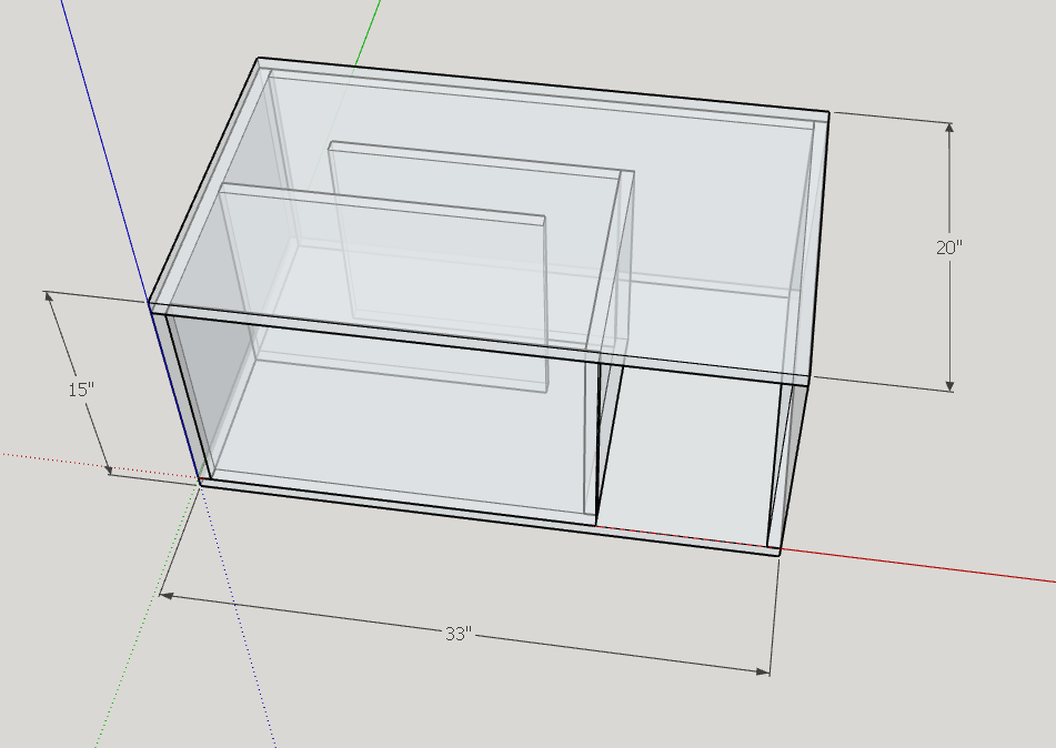

OK, here ya go.  I modeled the box in Sketchup to pull specs from it for HornResp.
Here is it compared to a 2.75 cu ft ported box tuned to 35 hz:
The black line is the ported box, the grey line is the horn.  The tuning on the horn came out right at 38 Hz as the calculator predicted, so that's good.
As you can see, the ported box reaches a bit lower, due to its lower tuning, but the horn has quite a bit more output above 40 hz, and has flatter frequency response.  As long as you wouldn't miss a couple Hz of low end extension, the horn seems like the way to go.
