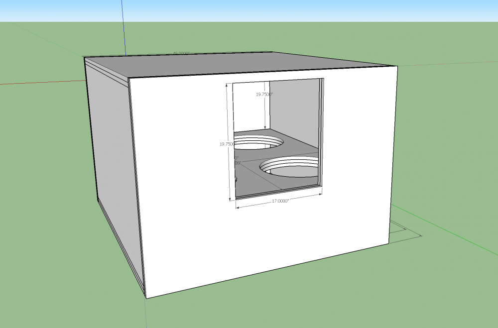

Hey,
i just got 4 fi sp4d2 v2+ 18s and i wanna do my first 4th order. Really only wanna do it for music and the port tuned to around 45hz. I will be powering them on 2 crescendo bc 3500 half ohm each and eventually get 2 more. this will be going in my 1998 2 door tahoe and the max dimensions are H 35.75", W 49", D 55". Would this be enough space for 4 18s? If im missing anything please let me know.
Thanks!
Ok so ive been messing around in google sketchup and so far ive got 14.88 cuft sealed side and 27.34 cuft. internal demensions of ported side are H-19.75" W-46" D-52" and internal demensions of sealed side is  H-10.75" W-46" D-52"  is that enough space?5b17ca67dd24cc090a4d8fa3031368f8.thumb.png.deeebc50b18291835ee29ca966ce6a7f.png
