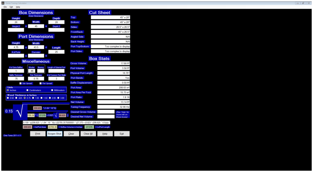

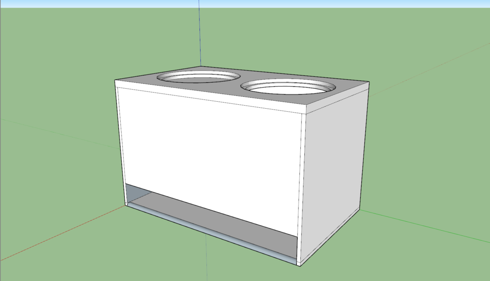

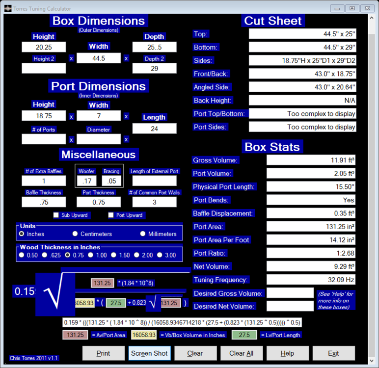

I have a few options for my next project and I'm trying to see if anyone can eyeball these two boxes and see which might work better.
I have attached a link to sketchup files for both enclosures, and will attempt to link Torres screenshots.

Edit: The main question i have is that on the enclosure for the 18's has one woofer very close to the port wall, almost flush actually. If i can get away with that then i will, to run 18's.

The subs will be Soundqubed 15" or 18" HDX3's, And the amp isn't concrete but I'm shooting for around 3k rms.
