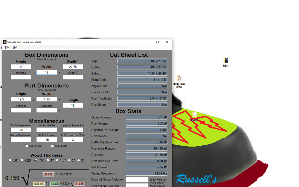

So, I have the 2010 version and the 2011 V1.1. Which version is most accurate?
Input specs
H=14 W=18 D=27.75 .  Both of the cut sheets match.
Port  H=12.5 W=1.75 L=18
Misc .20 displacement , # of extra Baffles 1, Baffle thickness 0.75, port thickness 0.75, common walls 3
2011 2.61 net volume Hz 31.51
2010 2.52 net volume Hz 32.06
I thought i had it figured out but my work computer has Version 2011 and the home computer has 2010.
So, which version do i use?
 What's the difference ?  I don't need an extra baffle with version 2011 to achieve the required Net volume and Tuning Freq.
                                            I did need the Extra Baffle on version 2010 to achieve the required Net volume and tuning Freq.

I would go with the newer version.  The difference between the two is in how it calculates the port volume.
Keep in mind that a .09 cu ft difference in net volume isn't going to make ANY difference in output.  Its just too small to matter.

Thx for the response. I will go with the newer version.
