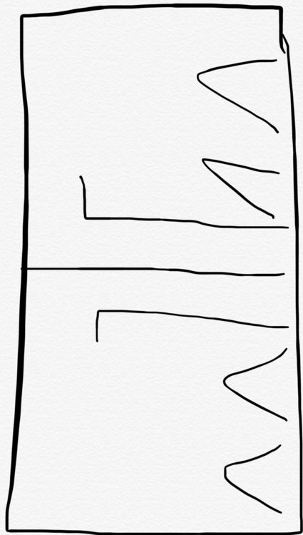

BubbaJ Posted August 15, 2019 Author Report Posted August 15, 2019 Current box dimensions: 60 1/2 length 20 deep 20 height all 1” mdf top is double baffle Max dimensions: 60 1/2 length 20 deep 22 height Port in my current box: 14 1/2 height to a 45 then the L length that goes into the box from the 45 is 5 inches It’s a 2006 GMC Sierra ext cab no back seat. The box I have now is sub up port up 7 hours ago, BYTizzle said: Whats the vehicle and the dimensions of the area you plan to install this box? Also, I have Termpro so if you have your current box and port dimensions I can make you a graph pretty easily to show why the box isn't performing how you'd like possibly
BubbaJ Posted August 15, 2019 Author Report Posted August 15, 2019 3.25” each pair of subs is chambered off into one side of the box so 2 share a port and other 2 share a port

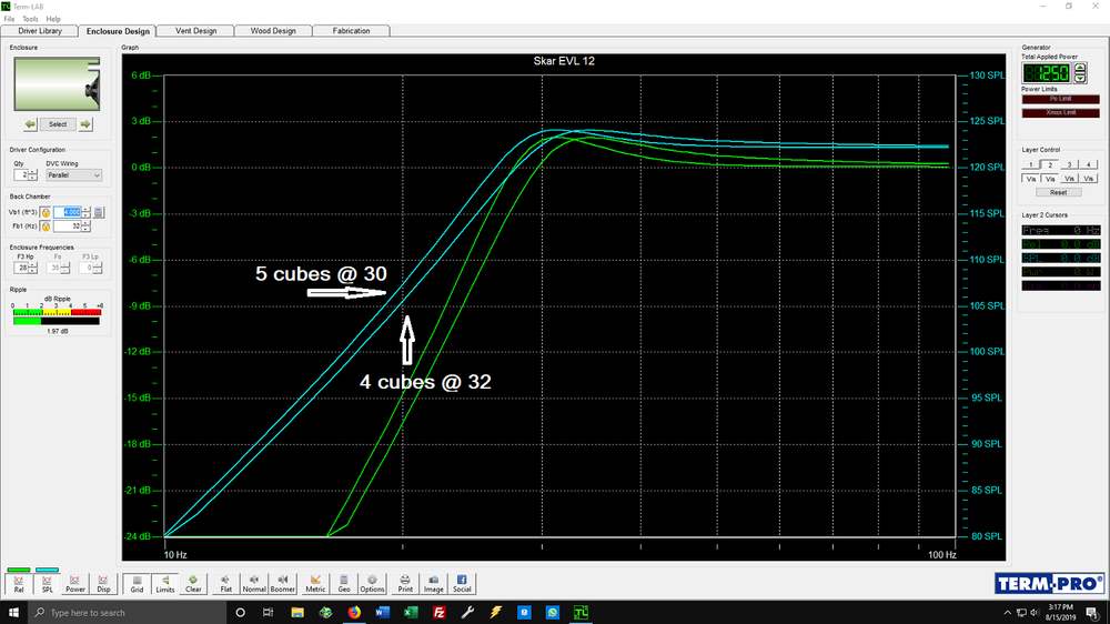

BYTizzle Posted August 15, 2019 Report Posted August 15, 2019 Seems like about 5 cubes net per side tuned at 30hz with 47sqin of port area. It's a little over the size they recommend but as long as you aren't overpowering them its actually helping add some output below 30-35hz area. Can you post a pic of the amp settings? And what Amp BTW?
BubbaJ Posted August 15, 2019 Author Report Posted August 15, 2019 It’s basically like this lol sorry for the drawing. I’m running a taramp hd3k. I tuned it all with a oscope. Headunit is a pioneer nex double din. Future plans are a taramp md 8k running lithium.
BYTizzle Posted August 15, 2019 Report Posted August 15, 2019 That's what I was picturing in my head and did the box calc off just 1 side. I believe my measurements were right and I did graph it in TermLab and I don't think the box is the issue here. Is the Subsonic set too high maybe? This is what you have now vs the recommended.
