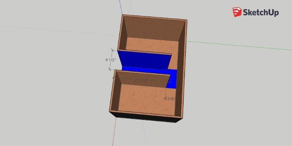

jkmoore1987 Posted August 22, 2019 Report Posted August 22, 2019 Hey everyone, I'd like some input on the port in an enclosure I am building. It will be for two subs, up firing, with a rear firing port. This is a shared volume box. In my modeling, the inside ends of my port are coming in at 5 5/8" from the rear wall of the enclosure. The port is 9.5" wide, so if the port needed to be longer the side extensions would need to be 4.75" wide. But it doesn't need to be any longer, and I'm wondering if the 5 5/8" of space left is enough clearance that the tuning or airflow won't be affected. I've never ran into this issue, with a port running that close to the wall. Any thought? Will it work, or should I look at other port options (aero port, running the port along the bottom width of the enclosure, etc.)?

jkmoore1987 Posted August 24, 2019 Author Report Posted August 24, 2019 Maybe this will make a little more sense, see how the port ends leave the 5 5/8” gap to the rear wall? Sorry I didn’t add the picture before, it was definitely needed. Thanks.
Triticum Agricolam Posted August 24, 2019 Report Posted August 24, 2019 Yeah, that will definitely lower your tuning. It shouldn't hurt performance otherwise, but tuning will be affected. If it were my I'd put a wedge deflector on the back panel to improve airflow. "Nothing prevents people from knowing the truth more than the belief they already know it.""Making bass is easy, making music is the hard part."Builds:
jkmoore1987 Posted August 24, 2019 Author Report Posted August 24, 2019 Good idea on the wedge. The spec of this box is 14 cu. ft. net tuned at 32 hz for 2 Fi BTL 4 18s. Any ideas how badly it would effect tuning? I don’t care if it drops 1 or 2 hz, just not wanting it to end up in the mid 20s or something. If it were you would you stick with this or entertain a different port style? Your enclosure pics are very nice btw. Thanks for your help.
Triticum Agricolam Posted August 24, 2019 Report Posted August 24, 2019 It shouldn't lower the tuning much. Maybe two Hz. What is the internal height of your box? I'll check your numbers. "Nothing prevents people from knowing the truth more than the belief they already know it.""Making bass is easy, making music is the hard part."Builds:
Triticum Agricolam Posted August 25, 2019 Report Posted August 25, 2019 18 hours ago, jkmoore1987 said: It’s 24 1/4” tall inside. So based on the dimensions you gave, I estimate your tuning will come out at about 29 Hz. "Nothing prevents people from knowing the truth more than the belief they already know it.""Making bass is easy, making music is the hard part."Builds:
jkmoore1987 Posted August 26, 2019 Author Report Posted August 26, 2019 Good deal, I can live with that. I love the lows more than anything. Thank you for your help.
