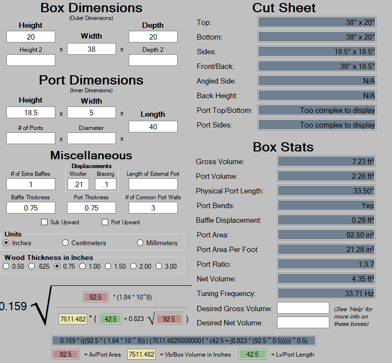

I'm planning on building a new box for my FI audio sp4 v1 15 with a scv-3000 amp its going to be the first box i have built can someone just double check to see if I'm on the right path? Those are pretty much the max measurements i can fit into my back seat. Im wanting it at 32hz and do you think the sub could go into the middle of the box on the side fine?  spacer.png
Unfortunately the RE online box calculator isn't very accurate.  It doesn't account for things like sub displacement or bracing displacement.  If you can get a copy of Torres it will be more accurate.  Or even better, design the box in CAD software like Sketchup.
Builds:
Here is your box specs in Torres,  I tweaked some numbers a bit to get things to fit better and included a double baffle.   I've found that your actual tuning comes out a bit lower than what Torres shows so you should end up right around 32 hz.  You will want to make sure you have some internal bracing for sure.
Builds:
Also my last question is i have very limited space this is going in the back seat in a Camaro , Would it sound better if i had the sub and port facing the ceiling vs firing on the back seat i only have a max of 2in of clearance from the port with that build.

This may sound stupid but how do i make the port length 40 if the box is only 38? or is that the total length of the port?
The port wraps around the side of the box and along the back.  Your 40 inches of total port length is when measuring down the centerline of the port.
