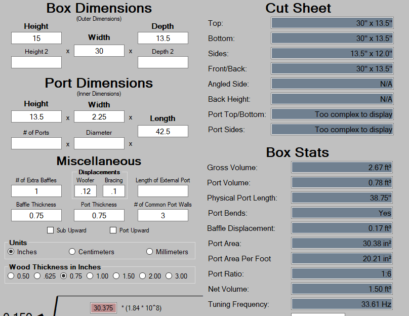

Long time reader to this website first time post.. ive got 1 DC xl 12 m4 at 1ohm on a DC 2k... im having troubles finding an adequate box and or box design for just 1 of these subs. more that one i see plenty of designs and prefab crap for but im wanting to make my own...for now untill i have the time and design im using a prefab crap "2cubft. slot port, so after displacement its about 1.81 supposedly tuned at 32hz... window meter says other wise ... my max for measurements are H-15'  W-30' L-15' way bigger than sub needs ... can anyone help me out?
Here is my suggestion:
