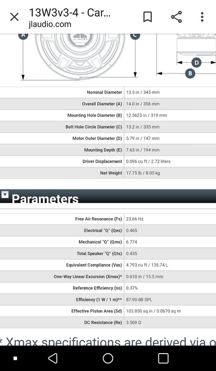

Hello. I am fairly new to box building and ports.  I have a 3 cubic foot internal box, subwoofer displacement of .093 cubic feet.  I want to go with dual ports.  I have 3 inch and 4 inch diameter pvc pipe.  What would you recommend, single or dual ports and 3 or 4 inches diameter?  The sub instructions say tune to 27 hz.  It is for home audio use.  Its a jl 13.5w3v3. Is that a good number to tune?  Any help on port size would be great, I am ready to cut the holes and pipe now.

I would use two 4" ports, they are going to have to be about 30" long each, they are going to take up about .5 cubes of internal space and that's still not going to get you quite to 27 Hz.  Making them any longer to try to get to a 27 hz tuning is just going to take up even more box space.
For future reference, you REALLY need to know how you are going to do your ports before you start cutting wood.  Adding ports after the box has already been built almost always results in difficulties.
