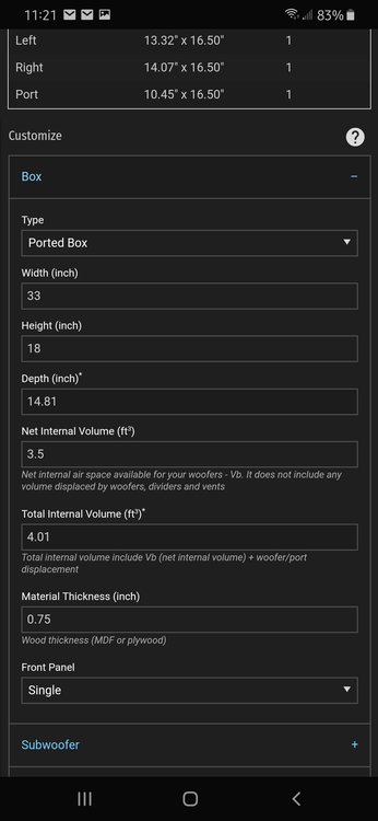

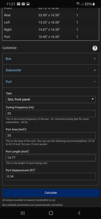

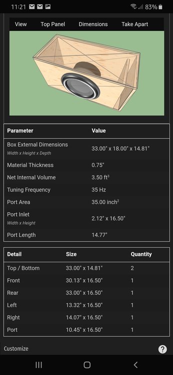

This is what I'd like to do box wise. I'm trying to downsize from the 2 12s I have space wise. Will these dimensions work. And is there a big difference between 33 and 35 Hertz. crossfires manual recommends 3.5 cubic ft. 35 hertz port area 35 in. Any help would be appreciated. thanks
