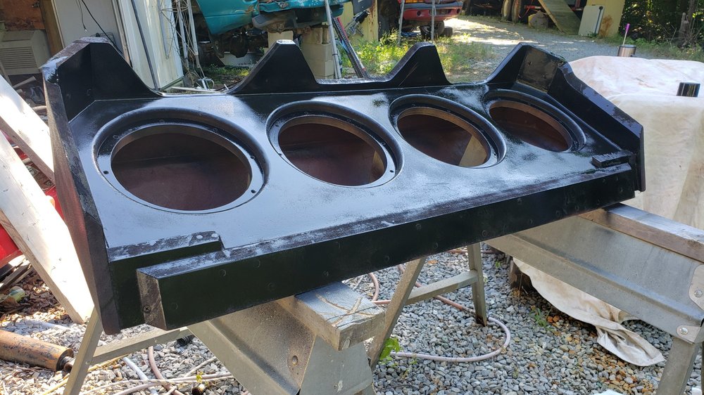

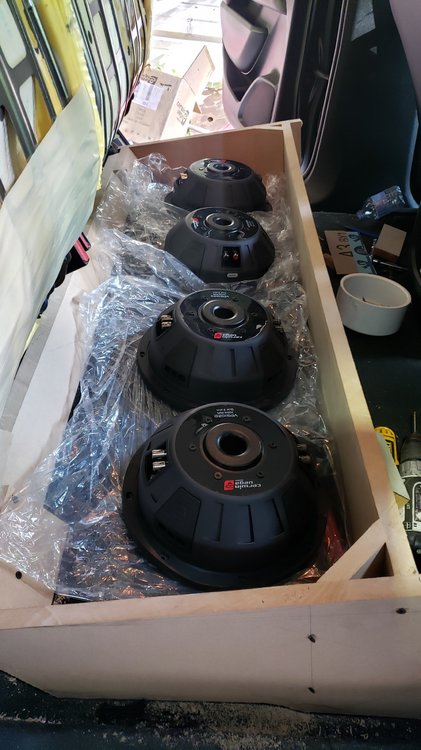

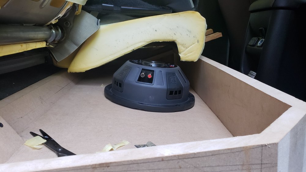

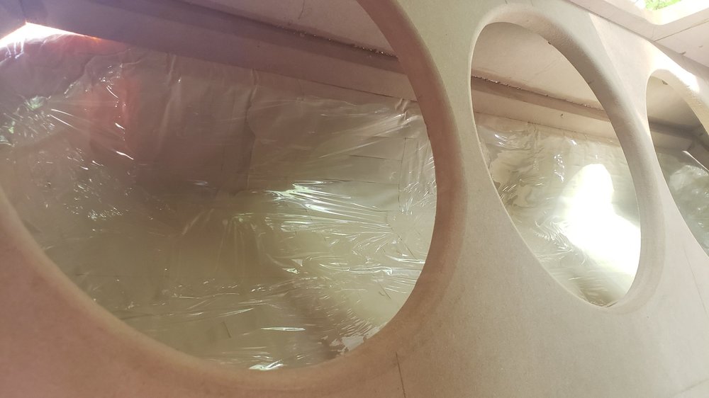

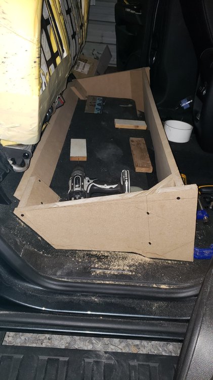

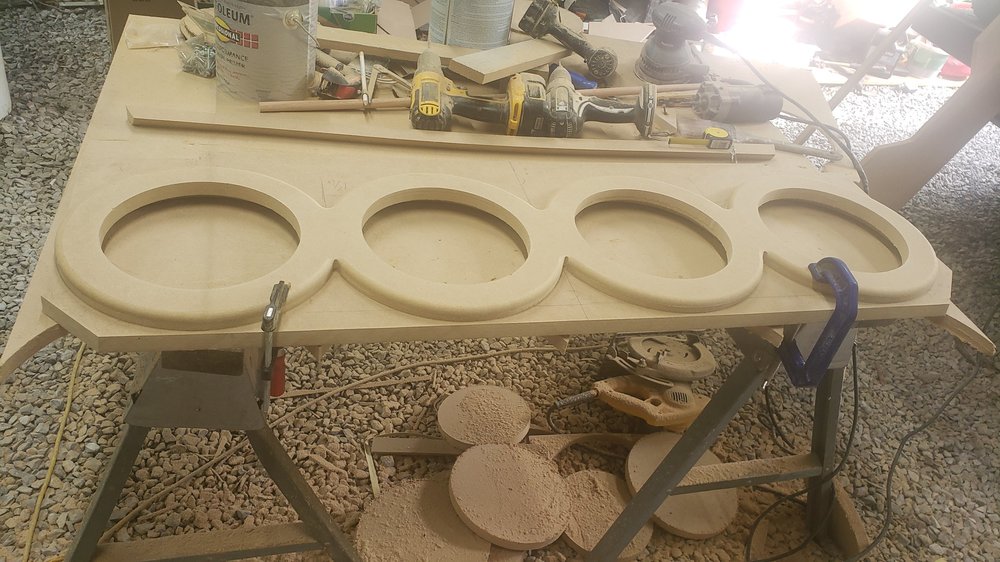

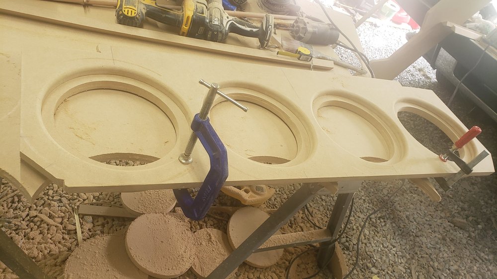

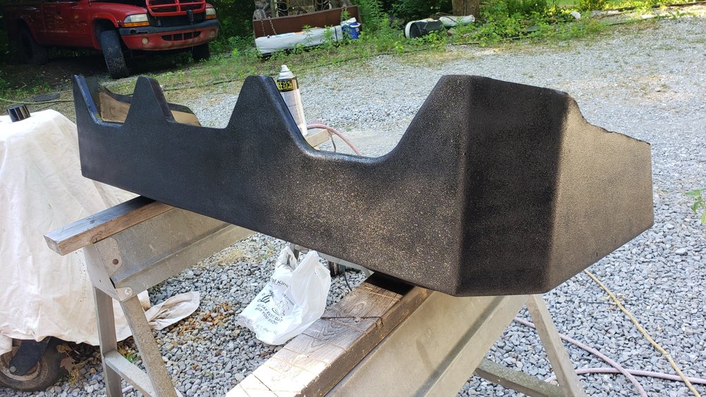

I built a under rear seat box, with a fiberglass top, molded from the bottom of the seat.
6 layers of 1.5 oz, with added in corners and layers for stiffener, and stiffer er from faceplate to glass between each sub, box is solid.
Been running and working good,
Many pics and specs on my thread on
Coloradofans.com
https://www.coloradofans.com/threads/4-cerwin-vega-pro-shallow-10s-in-custom-underseat-box.416183/page-4#post-5289750

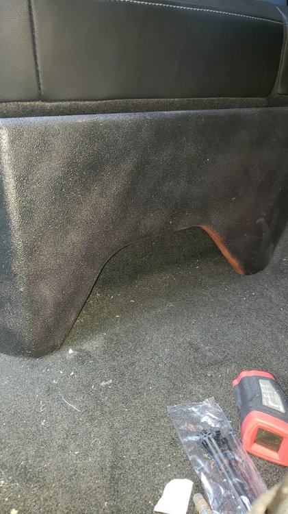

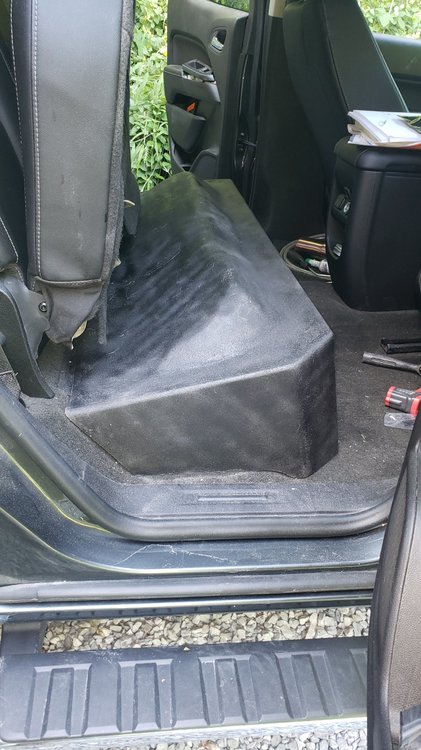

Outside, I used spray on berliner, then did a light sand, knocking the rough off, then paint, to give a textured finish that is durable, faceplate just gloss black.

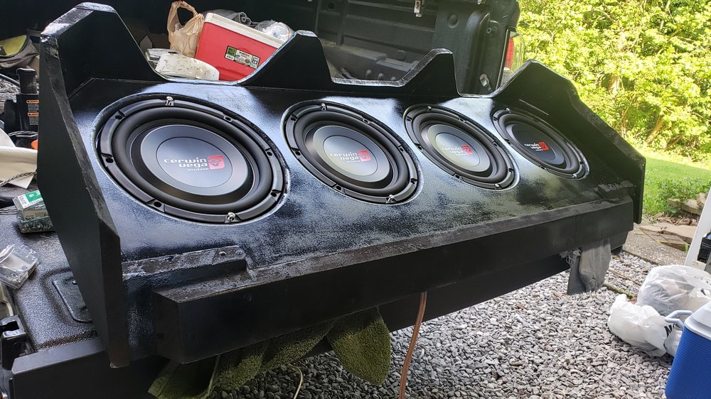

The subs are not flat, they are slightly angled forwards.

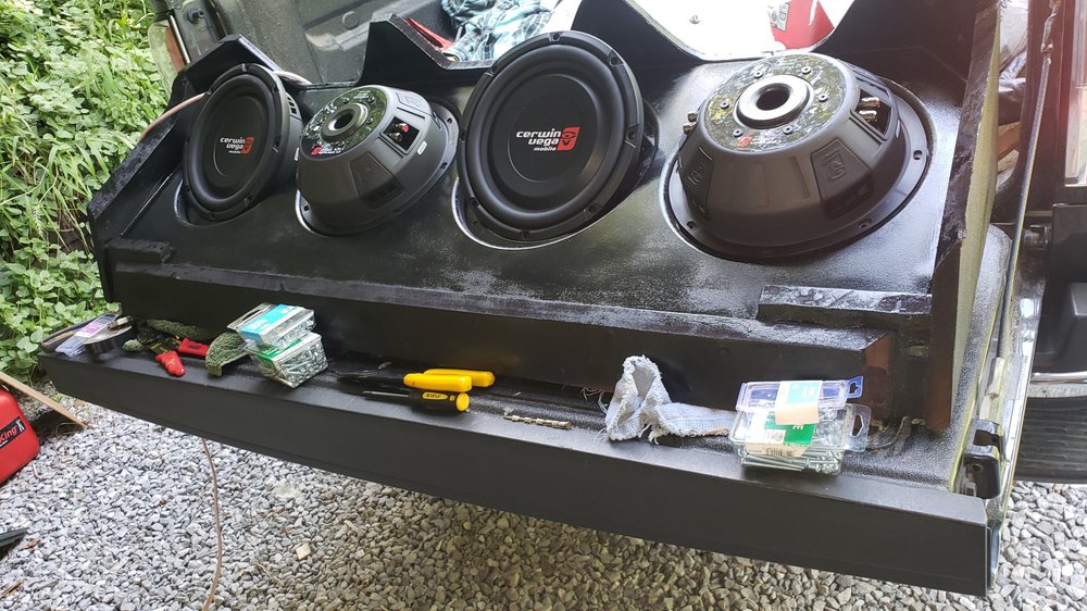

But I got everything to work and fit "4" 10 's under seat, and keep a full functional seat.
And stay within the box requirements for the subs.

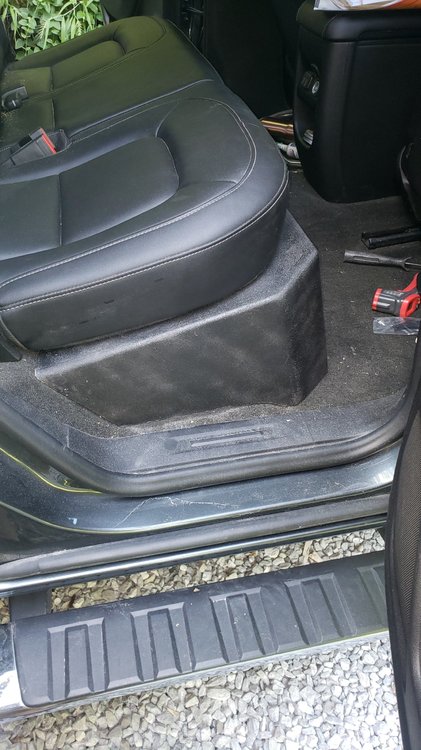

The pic installed, was just roughed in, was not finished yet, but shows the fitment.

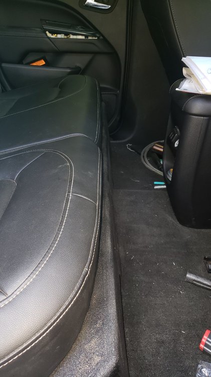

Box was played out and designed so the riders in the back, they do not rub their legs on the box.
