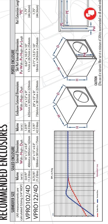

Their specs on sealed box is .4 cu ft and sun takes up  .03, so need. 43 per.
Checking some measurements, I can get a internal of 1.81, 4 is 1.72, added bracing, should be good.

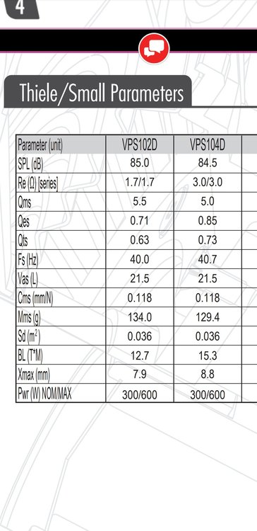

The vegas come in a dvc 2 ohm and 4 ohm.
Their spec sheet says they are 1.7 ohm and 3 ohm

Since the higher the frequency the ohms can go up, should configure on the 1.7 / 3 ohm spec sheet rating or the 2 / 4 ohm rating they call the sub.
If I go with the 3 spec ohm subs then perfect for my amp using 3 or 4 and order th
If i go with what they call a 2  ohm then it is better paired than the 4 ohm
The 4 ohm does have a higher xmax than the 2 ohm
I have really liked the skar skv2 series amp and was planning on keeping it, I have a pair of skar zvx and a new pair of vvx subs but they are to deep for what i need, i am going to leave the back seat in, and from looking through http://www.loudspeakerdatabase.com I picked out the vegas as making a down fire box

But the vegas say 4 ohm but specs say 3 ohm
Use the 2 or 4 ohm rating. The other rating is the DCR or something, someone who knows things about TS specs can explain how it is different.

Especially since they only need .43 cu ft per sub
