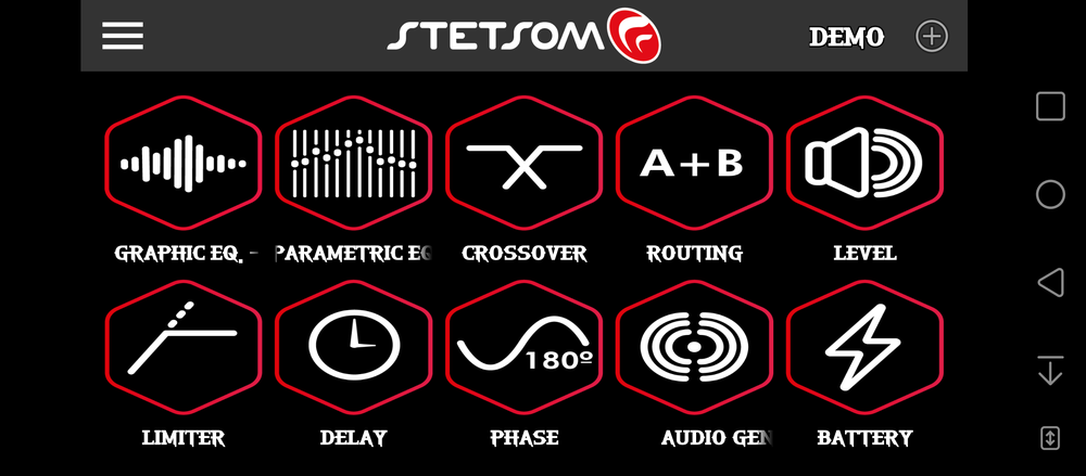

I downloaded the app and it seams pretty easy to navigate if not a bit basic. But it does add some features over my stock audio units Bass & Treble and SRS CS audio.  Like EQ, Time Alignment, Summing, crossovers, battery tracking, and phase adjustment.....but on the other hand it is from Brazil so that can be reason to be suspect. Plus only 4 outputs but don't need much more on a motorcycle. Probably won't add a subwoofer
