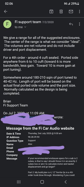

First time building a wall. Keeping it fairly simple.
4 FI Q 12s fully loaded
2 DC 3.5k's strapped
370 Mechman Alt
XS 3400 under the hood
3 XS 3100s in rear
I've actually already had these bad boys in a 4th order bandpass and they perform extremely well. I've spent many maaaaany hours between winisd and sketchup figuring out what's ideal for this ride. They were in a trunk blowthrough, but I said screw it lets wall this bitch. The blowthrough was a modular design and wasn't nearly as "brick shit house" as I wanted it to be.
They were strapped as well. Kicked like a mule with a wiiiiide bandwidth. Any links on good reading material or your own insight on the pros and cons of strapping would be appreciated.
I appreciate the feedback, but I just don't care for reflex or 6th. Hell, I even got FI's blessing on this configuration. I get it, these thing's qts are a fleas ass under the rule of thumb threshold between ported and sealed, but it's all gravy. I'm a sucker for the sound of a sealed box. This design stays. Because I like it!!
