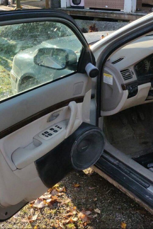

2xBass Face PAW10.1.4 as midbass in glass fiber pods in front doors. (May be ported in the future if possible)
(I heard someone i know tested them with 400W continuous clamped and they took it well, xmax is 7-8mm)

I haven't closed up the rear of the 10s that are in glass fiber pods in the front doors but I'm just waiting for warmer times to start cutting the metal in my doors to get at least of 15l of air space.
