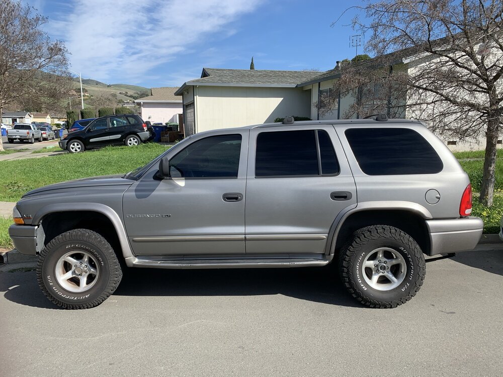

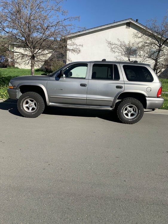

So I recently got a 2000 Dodge Durango r/t and want to upgrade the sound system. Only upgrade is head unit which is a new alpine halo 11 ILX-f11. Looking at dc audio level 5 subs but don’t know if I want to go 2 12” or 15”s all powered on sundown amps at 1ohm I will be removing the 3rd row seat to accommodate the systems 7-7.5 cu ft box and free up some space for carrying any luggage or groceries. If you have recommendations for subs shoot them below any help would be helpful
