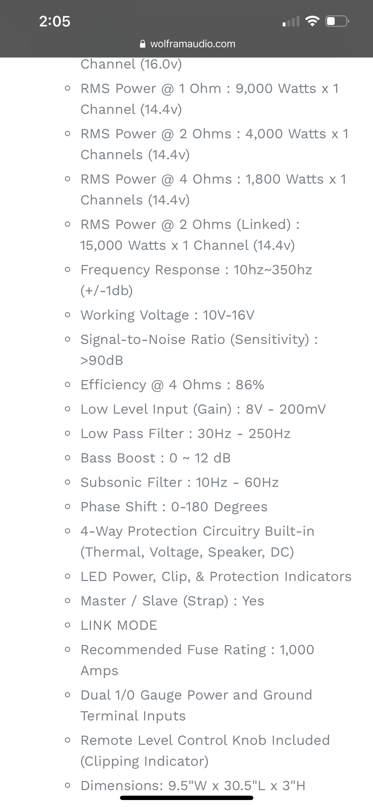

I’m working on hooking up a Wolfram AW9k amplifier and the manual has a 1000 amp fuse recommendation. I’m using dual inputs to the amp so it will have 4 power runs going into it and I’m not sure how to fuse it. Any help would be great thanks🙂
Simple as that :
Use a fuse for each positive wire going to the amplifier.
The value will have to be 1000A / Number of positive wires
In your case, dual inputs on two inputs is 4 wires so 1000/4 = 250A each fuse
If you only use single wire per input, 2 wires so 1000/2 = 500A each fuse
Tell me if I'm not clear :)
