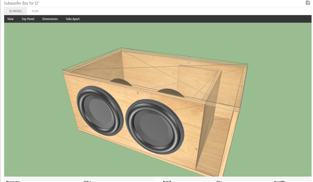

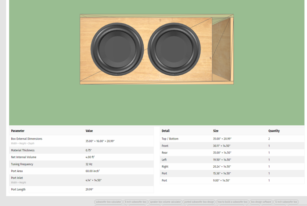

So im attempting to do my first slot port build and I want some opinions from box builders or people that have owned some vxf 12s.
Skar Vxf 12 calls for 2 cubes per sub with 30 cubes for the port area
The port dimensions are 4.14 x 14.50 for the inlet and the length is 29.99"
Net internal vol of 4 cubes, total internal 5.48 cubes.
On the website i have it tuned to 32hz
My question is is the box about accurate for the subs ? I hear people say that subbox.pro isint accurate on the port and that i need to lengthen it a few inches longer. Bought my 2nd vxf 12 through the skar summer promotion lmao so now i need a box for 2 vxfs.
