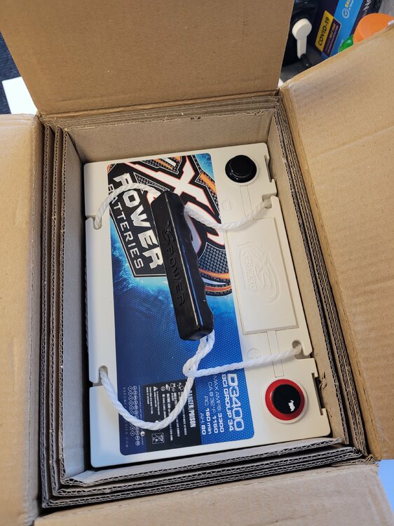

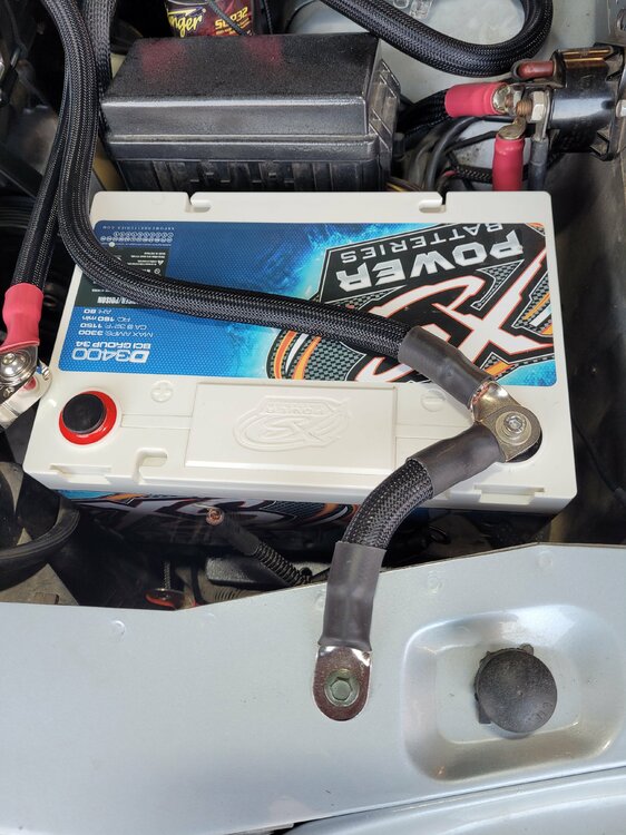

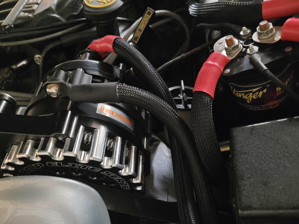

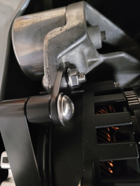

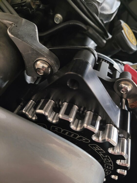

It's been a long time since I posted.  Finally really upgrading the electrical in the thunderbird.  New Mechman 370A,  this alt. Is not made for this car.  It needed a spacer and a shim.  It wasnt use any of the factory harness.  Tony at mechman was very patient getting me going with it.  Just a switched 12v excite wire.   XS power 3400 up front and added an XS power 925 in the trunk.  It never had a second battery before.
 I have build pics of the rear battery install  if these pics load.

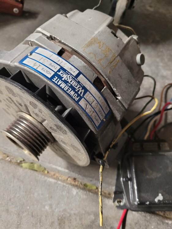

Out with the old, which still works.  This Wrangler 160A has been fantastic and still going after 27 years.
