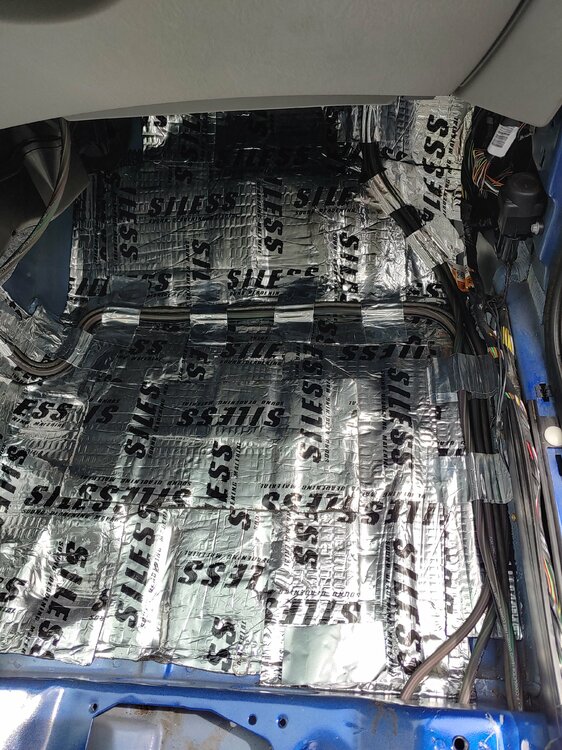

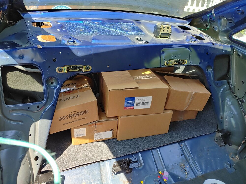

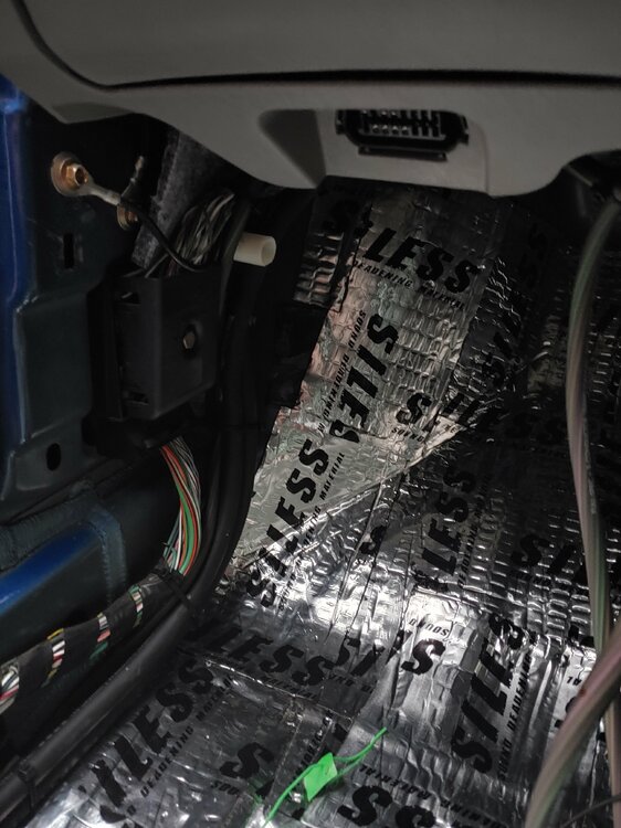

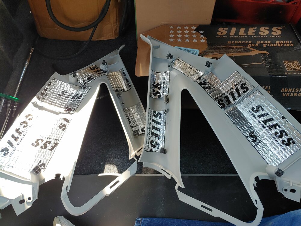

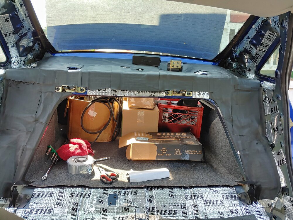

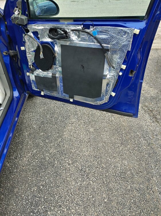

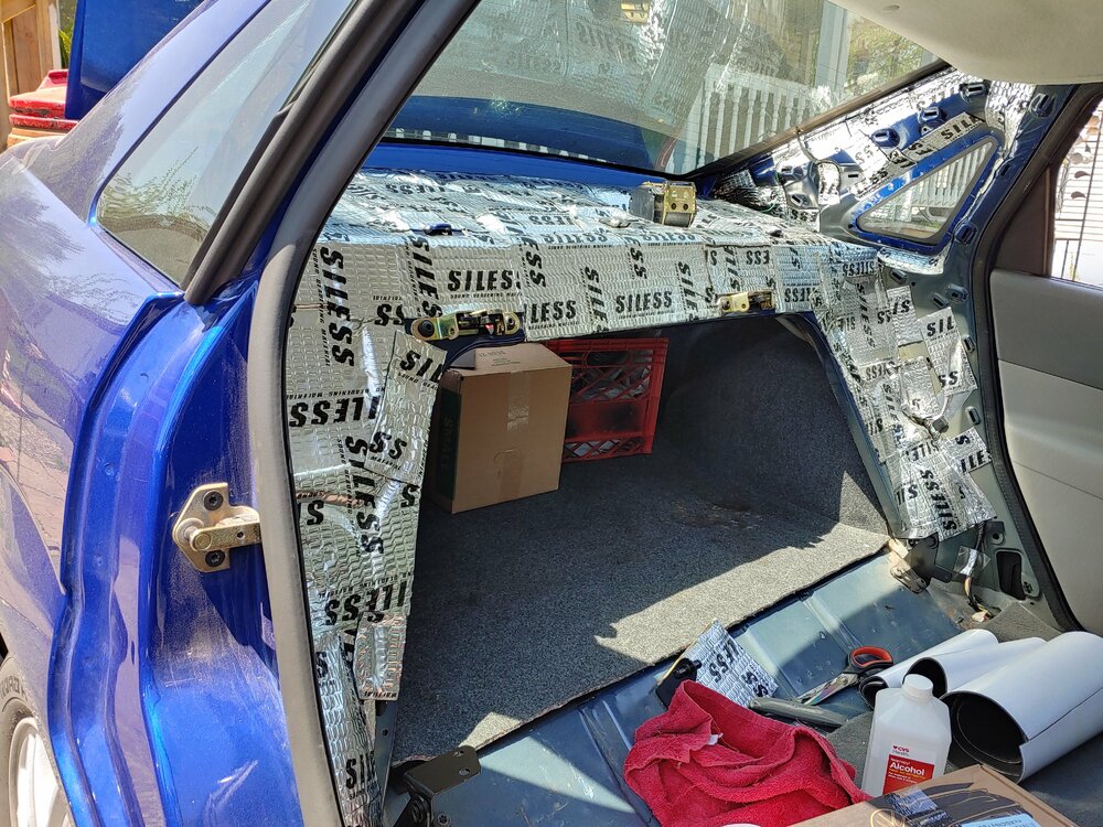

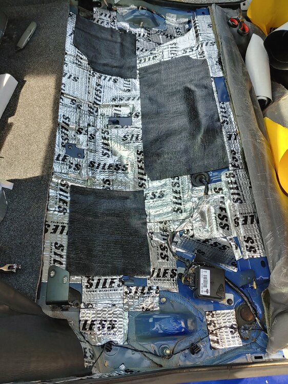

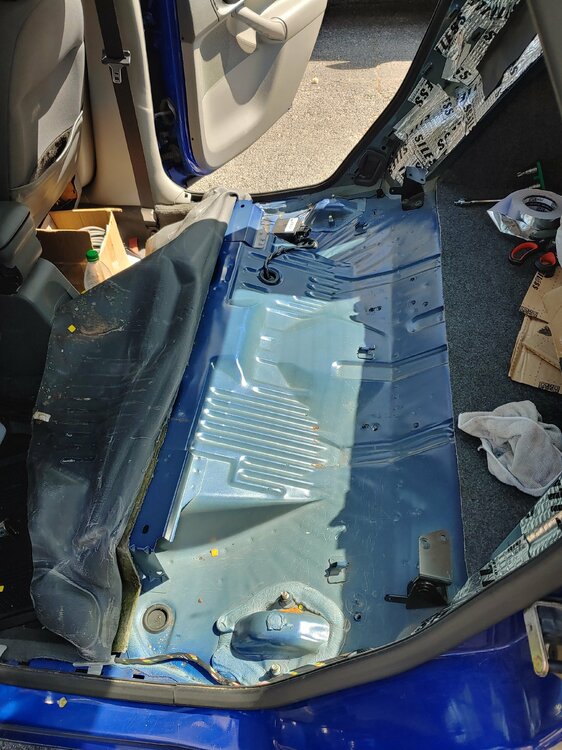

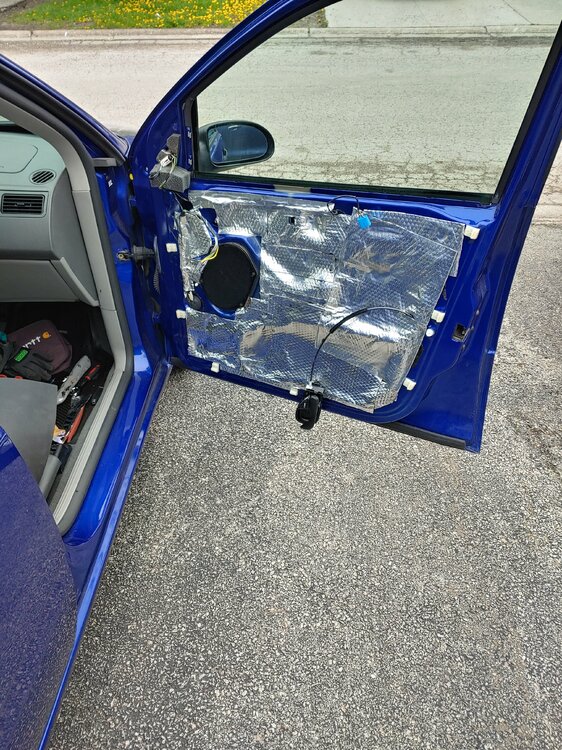

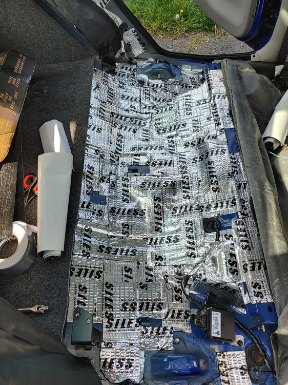

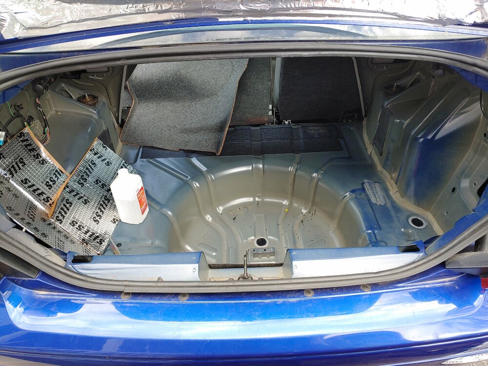

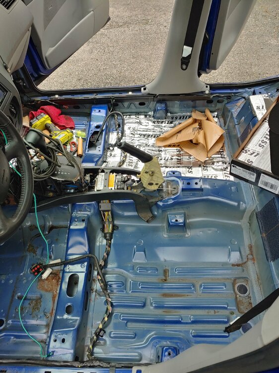

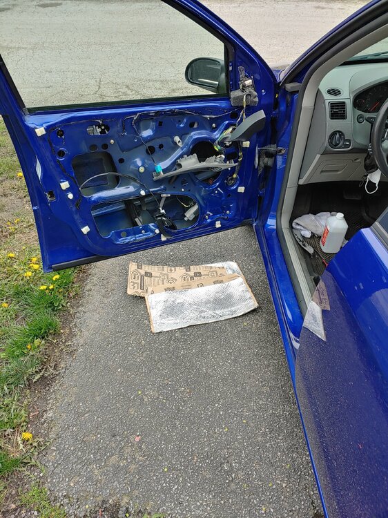

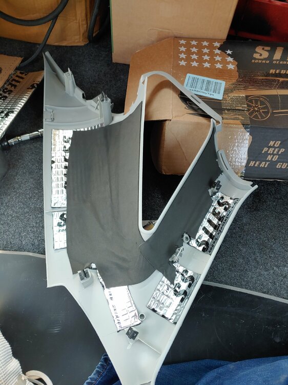

So, it's been a minute, but I have a new build that I am working on. I have made a ton of progress this month. Here is the progress I have made so far. I am using 80 mil deadener, 1/8" neoprene and 1-2 lb sq.ft mass loaded vinyl.

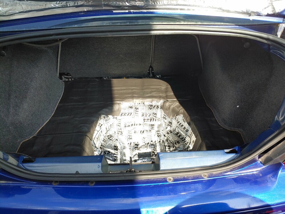

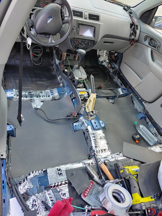

I used 2 lb. mlv for the floor in the cabin. Heavy stuff. I still need a piece for the trunk as well.
