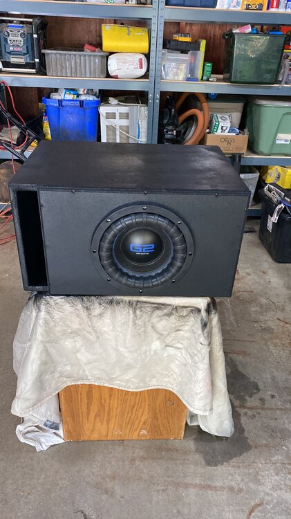

Sub is G2 Dynamics Genesys Series 10" Subwoofer Dual 4 Ohm × 1

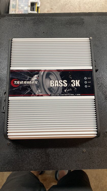

amp is a Tara amp bass 3k

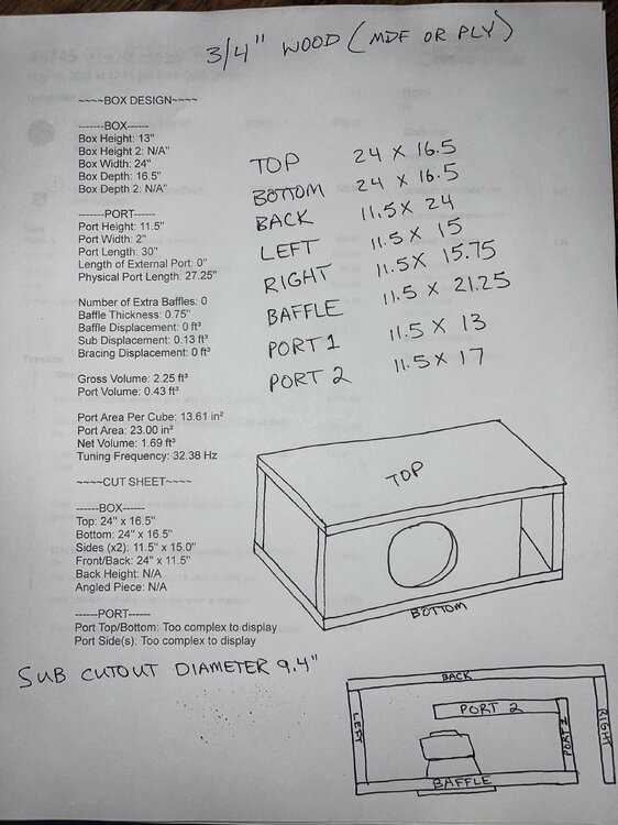

The box I built is a design from G2 dynamics

Your sub is dual 4 ohm and you can only get down to a 2 ohm or up to 8 ohm. After impedance rise your sub is maybe getting 1000 watts.
