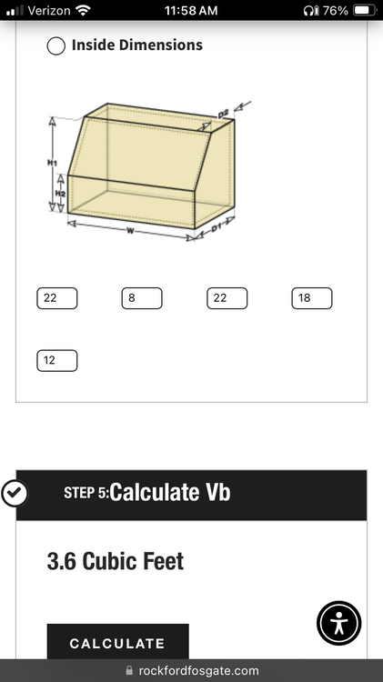

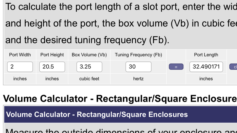

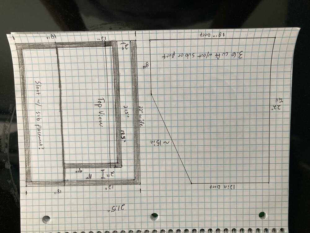

Hello all, I’m looking to build a custom wedge style box for 1 - 12” kicker L7S dvc2.  It’s goin in a 2011 Chevy Colorado ext cab so space is limited hence the wedge design.  I want to tune it to 30hz and either a slot or aero port would be fine with me, here is a design I started with a slot port but idk if this will work. Any ideas/advice would be appreciated
