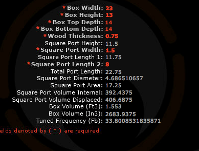

i just did this real fast just to see if something along these lines would possibly work?
or if i did
22
14
14
14
ive never really done any work with calculating box sizes so im sorry if im being a pain
or if i did
22
14
14
14
true. but there is not enough port area. 11.1sqin per cuft. try a 1.75" wide port or so.
edit: the red numbers, 25 14 13 13 .75 1.75 17 will give 1.55cuft and 33hz with about 14sqin of port per cuft
Edited by Krannyman92
and you think this will sound better then tuned to 38? considering i listen to mainly rock but also some rap?
