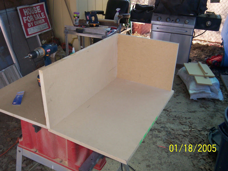

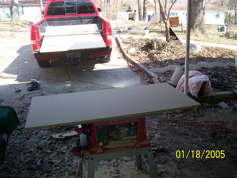

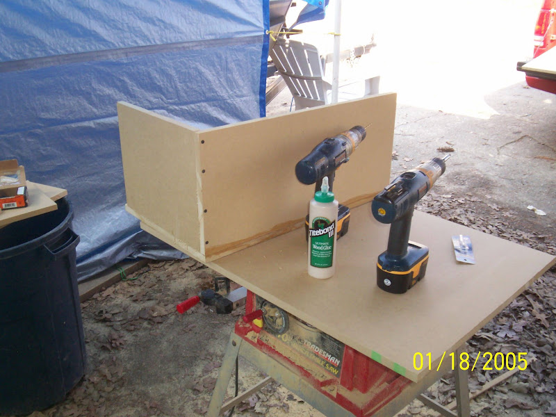

So in preparation of the new sub getting here soon. I Decided to build a new box today.
I have been playing with bass box pro and expos calc. Trying to come up with a decent box and stay with in my size limitations.
When I plug in the DC lvl3 specs the box I was getting was 11x24x16 and was barley 1.5cu^3.
So I farted around and finally got it to a size that was 2.36^3 gorss. And its 1.97^3 after port and sub displacement.
Its tuned to 38hz I tried to get it down lower but the port length wasnt cooperating with me.
Its not sealed up yet and I might decide to take it lower. I acutally probably will tomorrow when I reattach the baffle.
So the final dimensions is are 13x 26x16. With 29.00 in of port

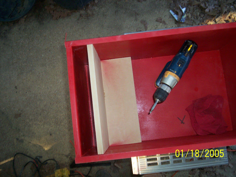

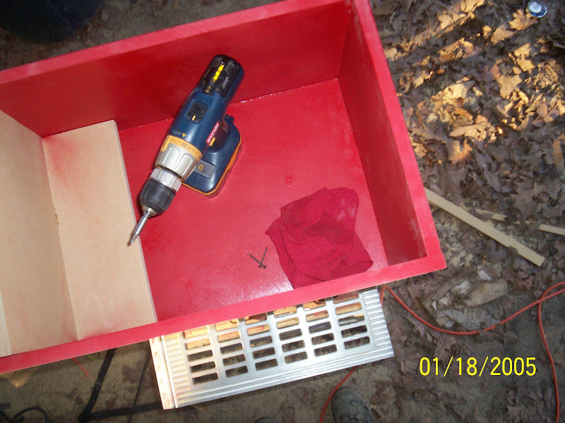

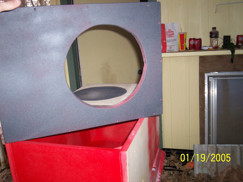

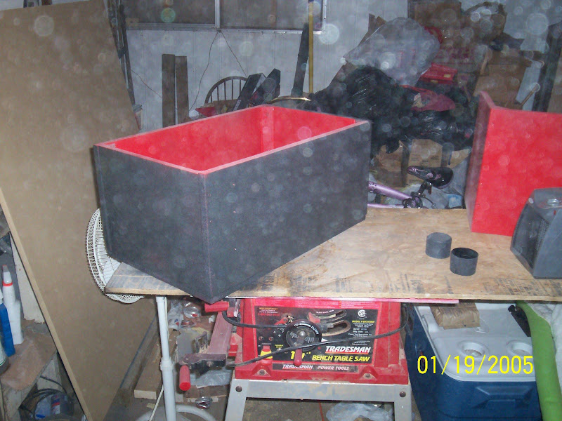

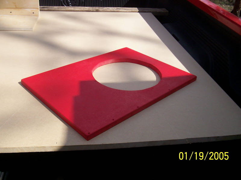

I did some more work today changed the port up some. Added the 45's and painted the hell out of this box.
First I decided to make the port a total of 20 inches. I think its actually 21 but either way it still puts me in the range I wanted to be tuned at.
I painted the whole box red not final coat red just get some paint on the box red. I almost went and bought some more paint and was going to keep it solid red but I talked myself out of it.
So I decided to paint he baffle with the fleck paint to see how it was going to turn out.
Before
After
I waited about an hour and let is sit in what sunlight I had to dry. It was looking like what I wanted. So I ran over to home depot and picked up some more cans.
I also grabbed some wood filler to patch a couple miss placed screw holes on the sides. And I also grabbed a tube of high quality silicone to seal all the interior joints.
Most of my cuts was spot on but some of them weren't as good. Even with a table saw I managed to make some curvy cuts haha.
After the silicone was still slightly tacky I sprayed the inside of the box to help conceal the silicone and to make it all appear the same color.
After letting the red dry to the touch I sprayed the entire box with the fleck paint. I was going to tape off the port but decided the fleck overspray wouldnt look too bad so I left the ort area un taped and after its done drying Ill be able to wipe off most of the overspray with a dry cloth. But it doesnt look too bad. I have a couple places I will have to touch up tomorrow but for the most part the pics below are the finished product. 102_0122.JPG

I put the baffle and port in today.
Decided I needed to test it with the memphis sub just to check for air leaks.
None that I could find easily.
Im affraid tho its not going to sound like I wanted.
I prolly should have waited on the fleck stone till the sub was here and I could test it lol.
Oh well its just money. If it doesnt sound good Ill just sell it locally to a guy I use to work with :P.
