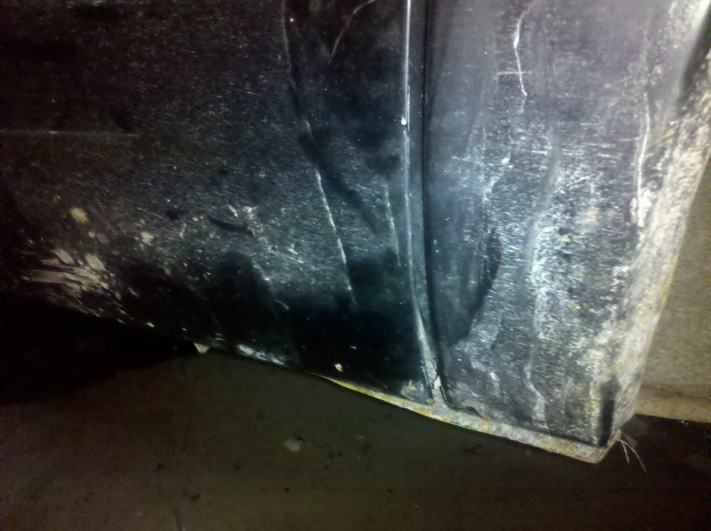

it looks like you have a c10 but here some pic's of an s10 just so you get the idea
here is a bagged s10 that lays frame.
as you can see the body of the truck is about 3in off the ground
Posted Image
now here a bodydroped s10
Posted Image
see the diffrence
