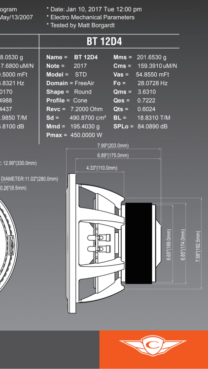

Looking for a sub with fs of 30 and qts of .6 plus or minus 2 on fs and plus or minus .02 on qts.
Cadence beast 12 140$ 800rms 1800peak or Rockville k6 12 75$ 600 rms 2400peak both d4 coils. what would you guys pick? I know you guys would tell me to save up and get other subs and by all means if you can find me a 10 or 12 with these same parameters or somewhere in between I'll definitely consider them but I doubt you'll find any. I can run up to 4k for power. Box help would be greatly appreciated.

2 k6s doing 151 on 3k. I have a rock ford prime 1200 and t1500, Memphis 1500 at 2 ohms, and 2 audiopipe apmi 2ks that if I wanted I could strap. These are my power options. I know 1 can't take 4k daily. I saw the cadence 15 takeing 1200 on a video, not free air, so that seems like it also takes rated power. Do you know what the ts parameters are for either subs you suggested? I only need the fs and qts for me to make my decision.
MOFO-124X - fs 30.3, Qts 0.44
T5.124 - fs 35.8, Qts 0.62
Cadence by 12 or Rockville k6 12 which should I buy
