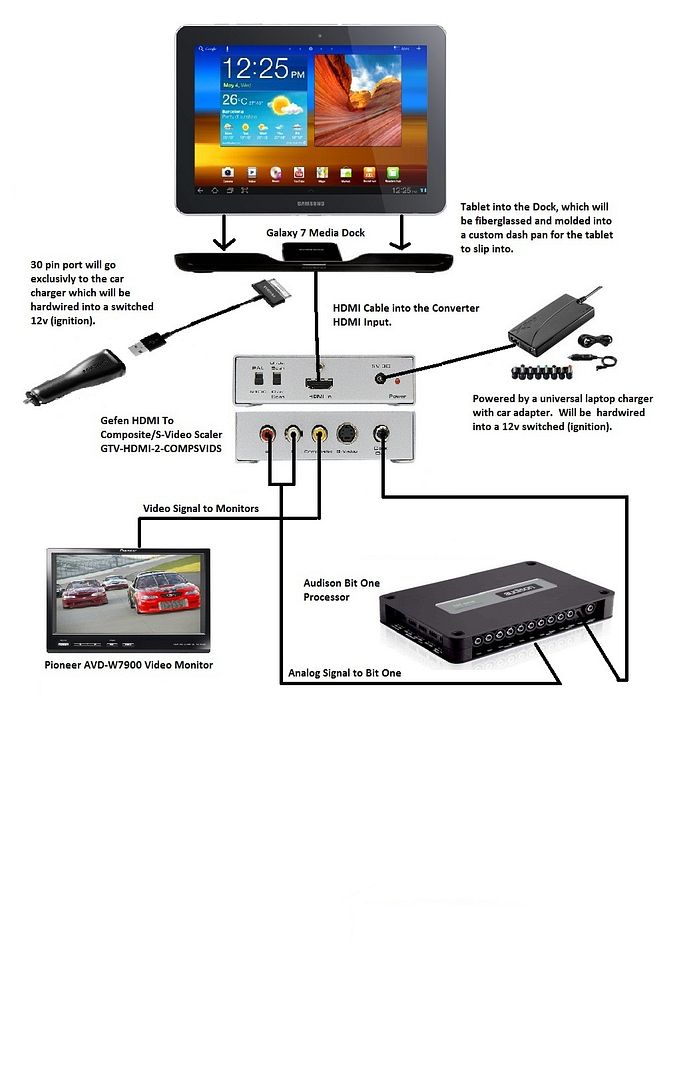

scooter99 Posted August 18, 2011 Author Report Posted August 18, 2011 Here's the latest and final drawing for the tablet install. Facebook Page: S99Creations 2006 F250 Lariat Build
scooter99 Posted August 18, 2011 Author Report Posted August 18, 2011 Thank you for your suggestions. I'll address all that when I get the components in. I'll for sure be bench testing it all to make sure it works as soon as they hit my front door. Do you have a better suggestion on how to get around the lack of accessories for this particular tablet? I'm actually please I got down from a bunch of different adapters and converters to one. I'm always open to suggestions. Facebook Page: S99Creations 2006 F250 Lariat Build

scooter99 Posted August 19, 2011 Author Report Posted August 19, 2011 Found a possible snag in my plans. After reading more on the Galaxy 7's docking station everything suggests the audio through the 3.5mm jack on the dock. However the HDMI cables carry an audio signal which can be converted through the converter that I'm going to use. However, my fear is that the port will not support the audio through the HDMI cable. So what I'm going to do is just order the dock. Once I get it, I'll test it out and see if it will work through the converter. If it doesn't then I'll go to the Media Tab like I was going to do previously before I found the dock conversion. Here's the catch. If I have to go to that adapter instead of the dock, I just found out they're not even shipping them or supposed to be released, until early or mid September. Not the end of the world, however, I'd like to find this out sooner rather than later. I'm going to go get my tablet today. I'm going to see if they have a docking station as well. That way I can find out as soon as my converter gets here. More to come soon! SOMEONE BUY MY HEAD UNIT SO I CAN PAY OFF THE CREDIT CARD I"M ABOUT TO USE!!!!! Facebook Page: S99Creations 2006 F250 Lariat Build
