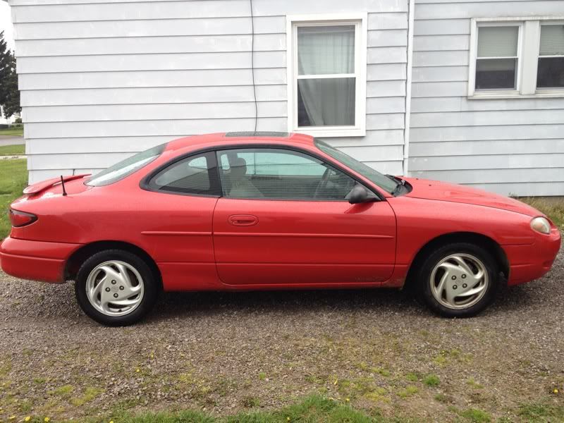

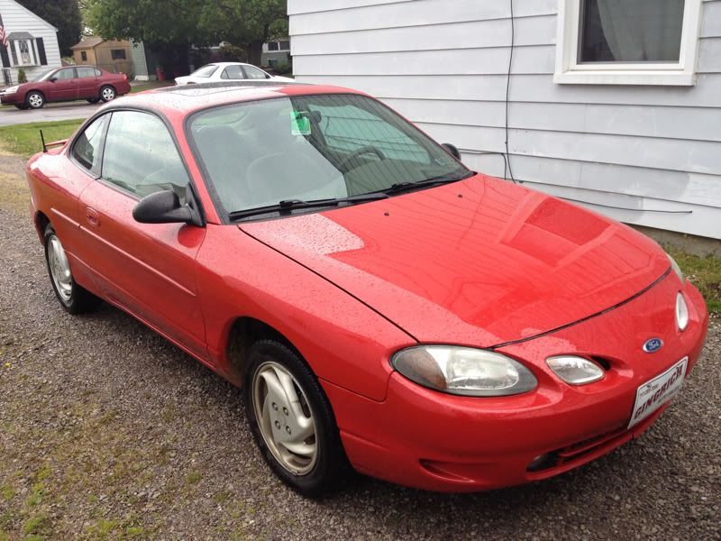

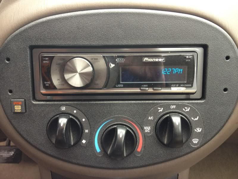

It has been difficult getting pictures together and everything because it's finals week and all, but here is the car that I have to deal with. It is a 1998 ford escort Zx2 sport.

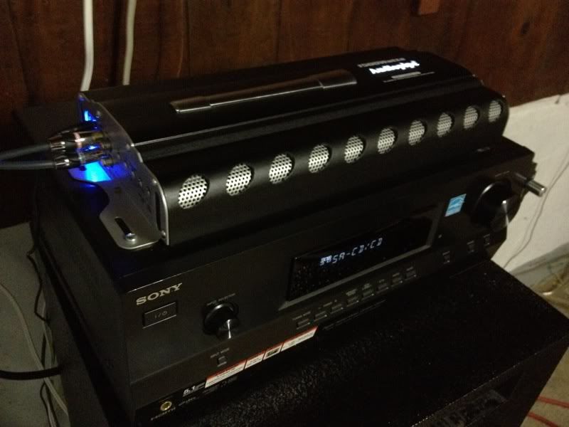

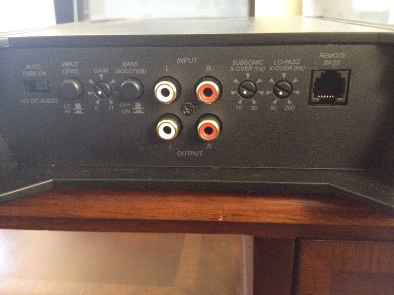

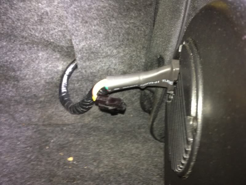

I also included some pictures of my current setup, the bazooka tube NEEDS to go

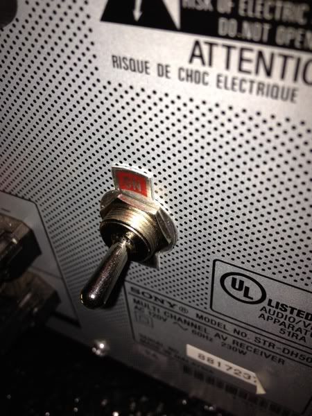

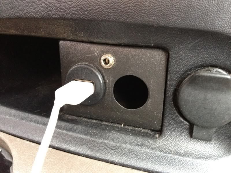

There was no front input for the usb or aux, so I made my own mount. The empty hole had a toggle switch for LED accent light strips but I decided to de-ricify the car and get a different colored toggle switch to use for the sub in my build

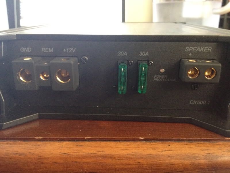

Just picked up real remote wire and 12ga speaker wire to run from the amp to the sub. I'm awaiting 4ga wire and stinger RCAs to arrive this week. Once it comes in I want to mount and wire the amp in my car until I can get a sub switch, bass knob, and gauge reducers to make setup clean and easy. Any recommendations are welcome and wanted. This is my first build log.

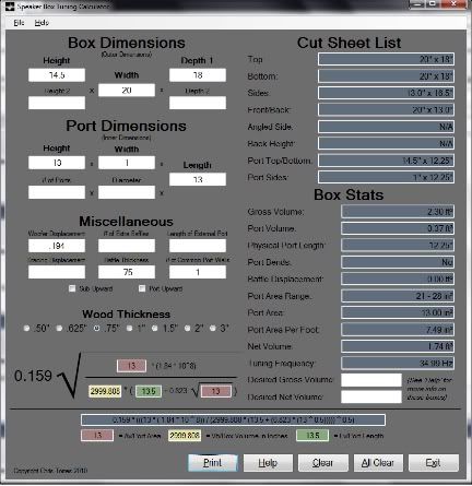

I'm almost done with finals so I had a little time on my hands to mess around with Torres Box Calculator. Here's what I've got in mind so far.
It's difficult to read, but it says:
net volume: 1.74 ft^3
frequency: 34.99 Hz
port area: 13 in^2
physical port length: 12.25 in
I have my eyes set on a Fosgate P2D4-12 and the site says that the sub displacement is .194 ft^3 so I went ahead and plugged it into the program. I'm starting to change my mind and I'm thinking about going with a Skar VVX-12 dual 4 sub :/ I've got 2 SA-12's in my house and I want to try something else out. Thanks for the input, I'm new to box building.
I may be mistaken, but I think you will need more port area per foot. You only have 7.5, and I think it is recommended to have at least 15 (or around that)
