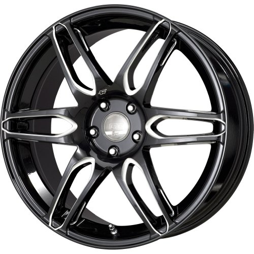

Also, in case you didn't see this on my facebook page, I had an accident this weekend. You all know I've been working on both my houses, the old to get it listed, and the new cause shit keeps breaking! Well I swapped out my dishwasher and microwave last week but still needed to take the ones from my current house over to replace the better ones I took out of the other house. Anyway, I had to move the car, to put the truck in the driveway, and I had a big run in with a curb drain by my house. It was completely a brain dead moment on my part. I can only attribute it to being sick and working as well this weekend so I was pretty foggy headed Saturday morning when it happened. But here is the damage. 64818_499470833445732_2118940249_n.jpg
Doesn't look like much in the picture, but it's about a 2 1/2" gouge in the rim and it sticks out like a sore thumb on this black wheel. I'm so upset about it. But on the other hand this may have helped me make my decision on getting new wheels. I have been thinking about it for the last few months, but I wasn't really ready to do that just yet. But I think after this I may be forced to. Not because these wheels don't work anymore, it's just the fact that this one is so messed up. These are the one's I've been looking at:
Falken RT-7M
or these
Falken RT-6SS
Both of those would be in 18x9's. I have the tires already and they're still in great shape. The only problem I have is, money as usual. I've been sitting on a pair of truck wheels and my original car wheels (SVT Sabbotini's) for years now and I simply have not been able to sell them. If I could somehow get those sold it would help me tremendously, and then of course I'd have to sell the Varrstoen's that I have on there now. Both of these new wheels are about $200 each. So I'm sure it'll be a while until that happens.
