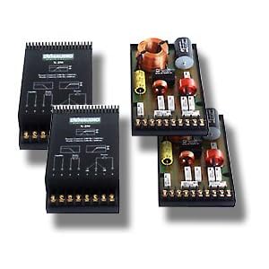

geekybasshead98 Posted July 13, 2014 Author Report Posted July 13, 2014 If you don't know, you're not ready for it. LOL Get two sets and that amp and you'll be happy. Look up active and passive crossovers. Something like this? Pioneer DEH-X6600BT (1) Rockford Fosgate R1200-1D (1) Alpine 1242D 12" Type R ported 32-35hz
OrionStang Posted July 13, 2014 Report Posted July 13, 2014 Passive crossovers are the ones that come with components, like the ones you pictured. They have set crossover points. When you run active, you leave those out and control the crossover points either through the head unit, the amp, or a processor. Not all head units and amps have the crossover range needed to properly cross mids and highs. Thats the short version. Now get to studying. SMD Super Seller My Feedback Thread
