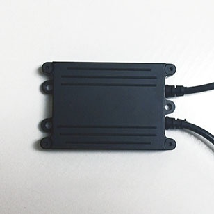

DDM 55w ballast gut shots & attempted supercharging
I got a DGAF attitude and popped one of these open
Rubber encasing the PCB. Pick it off (takes patience)
And there it is! Note the trim potentiometer towards the lower right, just above the red capacitor. Counter clockwise will reduce power output, clockwise will increase it
