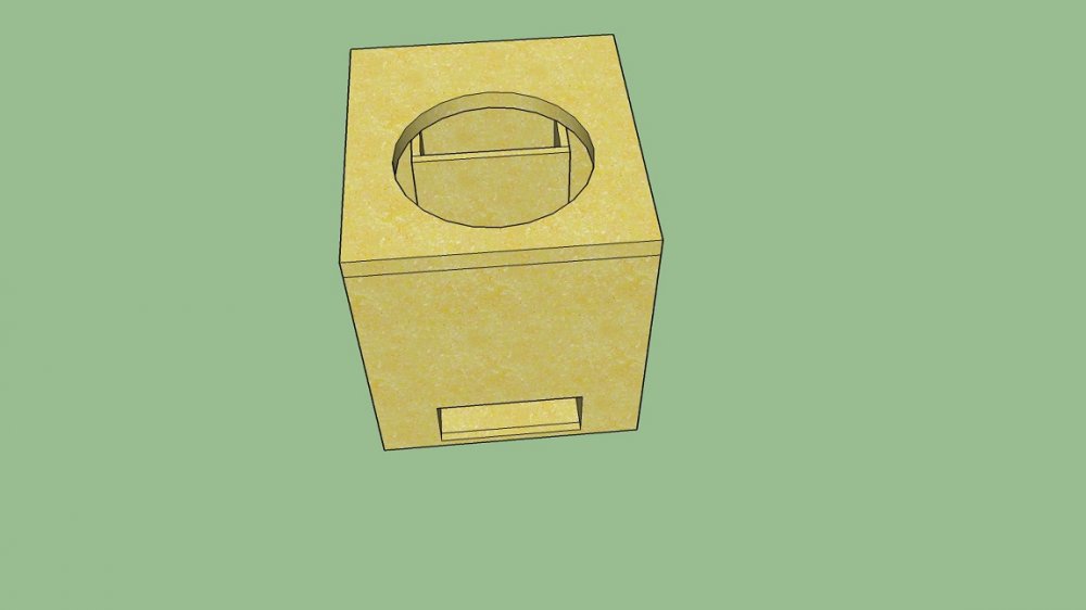

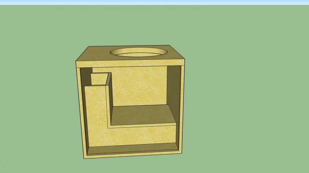

teardrop Posted January 4, 2017 Report Posted January 4, 2017 this should be great do you need a 3d sketch
Paco312 Posted January 6, 2017 Author Report Posted January 6, 2017 Looks good , Ya a 3D sketch would be cool , thanks I appreciate it..

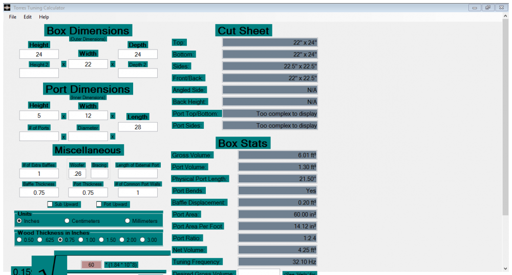

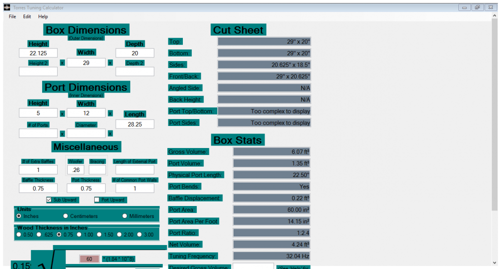

teardrop Posted January 7, 2017 Report Posted January 7, 2017 im sorry man ima hav to redo that design after i did it in sketchup the ports to long for the box ima redo this and sketch it up today for you
teardrop Posted January 7, 2017 Report Posted January 7, 2017 sorry about that first one and please let me know how it sounds
