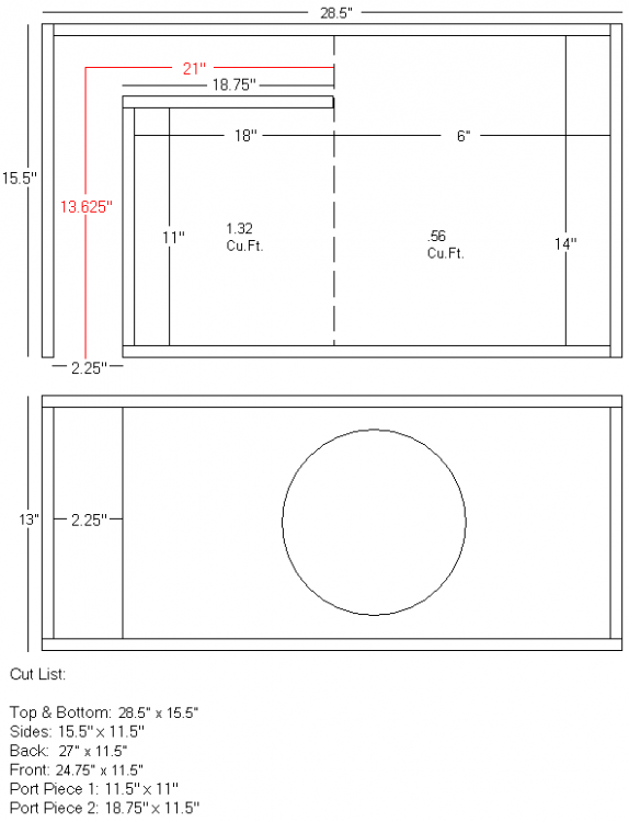

Jivko Posted February 13, 2017 Report Posted February 13, 2017 Hellо, I have Pioneer Premier 3004SPL. I just wondering what would be the best ported box design for him. In the current ported box, do not like how it sounds, car is sedan. Thanks for your help in advance!

Jivko Posted February 15, 2017 Author Report Posted February 15, 2017 Pioneer recommended enclosure 0.85 ~ 1.75 cubic feet for this speaker, what think of this box? 1.75@32hz
