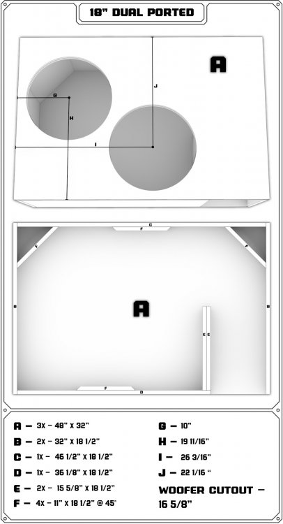

I'm looking for someone that can redesign or design a new box for me,  I want a box like this for 2 hdc3 18s, it'll be run on 3k. I'd like to tune low maybe 28 hz or so, the box pictured will fit great and leave room for batteries but I'd like the port to be facing the same way as the sub instead of going up to the roof. I emailed the guys at soundqubed and they said this box is tuned to 32hz
Do I have enough room for a wall and comfortable seating.  I have 64" wide at the bottom, 53" wide at the top, 48 " height,  and would like to stay under 22" deep. Could I possibly go 4 18s or just 2?  I've decided to go with a wall because it'll look cleaner and I can run my batterys in a  box on the bed
What vehicle do you have?
Pioneer 80PRS
I'd like to wall it but don't know how to design boxes or ports and wanna tune for mid 20s. Hoping I'll have the space for atleast 3 18s even better if 4.
Any ideas? I've been looking at similar builds and I think I'll have to stick to 2 18s, I'm wondering if I have enough space to do a 2x4 first layer and then I'll have something to screw my mdf to. I need some input because I plan to do this this week. Any help is greatly appreciated
