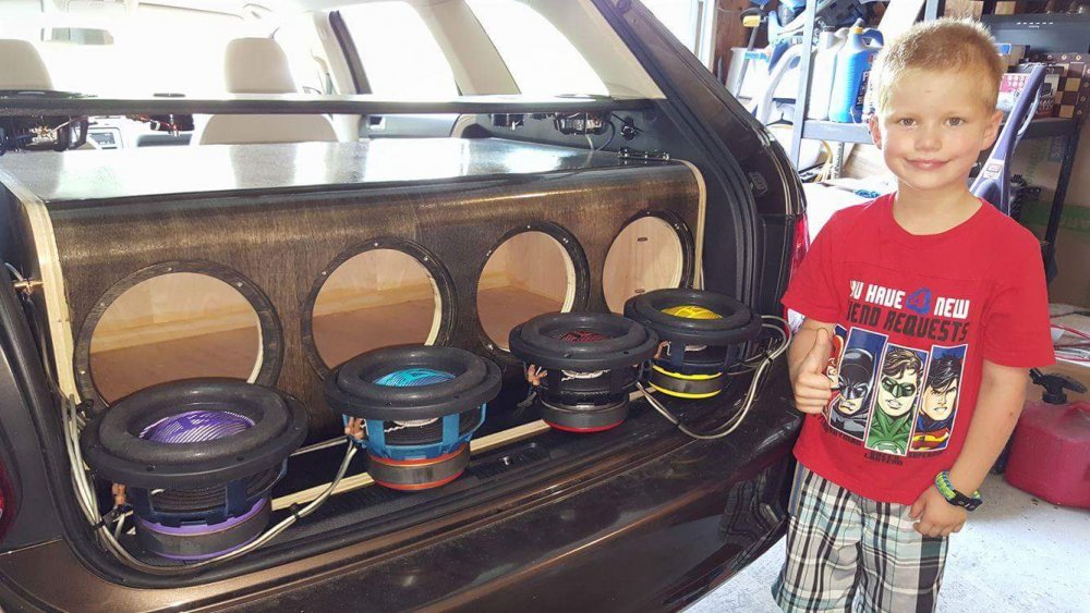

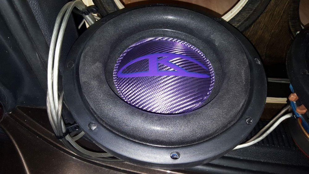

This first one is a Custom enclosure for 4 of my "superhero" built 8's. These are Kicker CVx motors from 12's, turned into 8's with color schemes that match superheros.
In here are (From left to right) Hawkeye, Aquaman, Antman, and Wolverine
The enclosure is a perfect 4 cubes, tuned to 28.5 hz
All work done by me.
