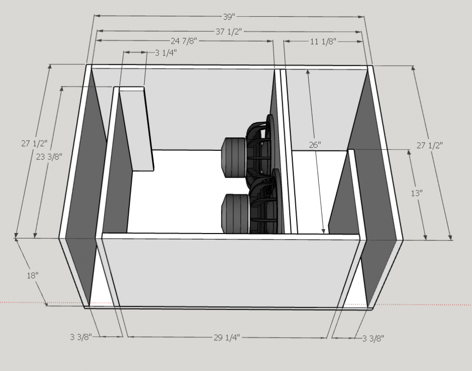

I want to put two lethal injection 12s in the back of my grand Cherokee in a 6th order. Anyone available to help? I have absolutely zero experience with 6th orders.

I really want the high output at a small band somewhere in the lows. I'll still listen to music on it, but I was to have those few frequencies in demo music that will kill. Also this is a temporary box for while I buy my other two 12s and I've always wanted to try a 6th. No power decided as of yet. Probably going to try to find a nice 2500
What kind of bandwidth are you hoping to get?

Like 30-34ish powerfully and decent-ish from 28-60

The 30-34 is all I really give a shit about.

If I end up hating the output and it's not for me I'm capable of designing a standard ported box. But I've always wanted to give a 6th a try

Thanks man! Max dims 39 wide 30 deep and 28tall. If that's not enough let me know but that's where I'd like it to be if possible

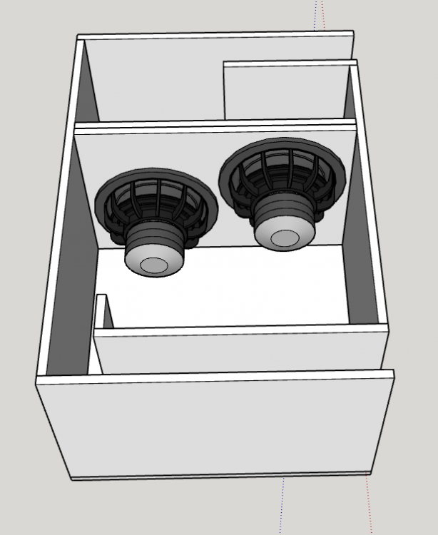

OK, here is what I came up with.  I did two designs, a series-tuned box and a parallel-tuned box.
First off is the parallel-tuned box. The specs are:
Rear chamber - 5 cu ft net - 27 Hz tuning - 60 sq in port area
Front chamber - 2.5 cu ft net - 55 Hz tuning - 60 sq in port area
Exterior dimensions - 39" W x 19.5" H x 27.5" D.  All panels except top and bottom are 18" wide.
BP6-1.thumb.PNG.b34db502c0b3aa5f1fd045835cbb68dd.PNGBP6-2.thumb.PNG.603cc4a5c4b20722b669ab1d05757272.PNG

If it were me, I'd pick the parallel-tuned box since it has smoother frequency response, more output above 30 hz, is smaller, and is less finicky than a series-tuned box is.  The series tuned box will probably get you more output real low though.  If you are really feeling adventuresome you could build both and see which you like best :-)
