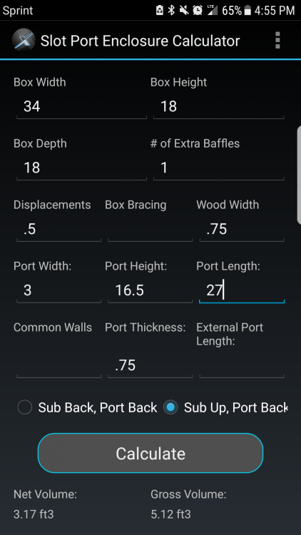

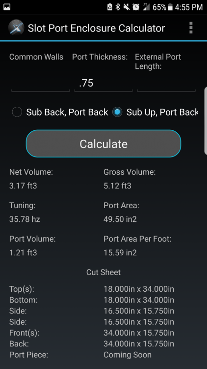

Max Dimensions are 36" wide, 24" Height, and 32" deep. I'd like the box to be around 3.6 Cubes after all displacements with the Subs firing up and port firing Back. Tuned to 34 hz. Thanks in advance to all who help me out!
Subs are 2 American Bass XFL 1244's
Amp is Audioque 2200.1 ( SoundQubed now )
That should work, but if you have more space you could get a little better low frequency performance by increasing your net volume up to around 4 cu ft, lowering your tuning to 30-34 Hz and increasing your port area to 65 sq in.
