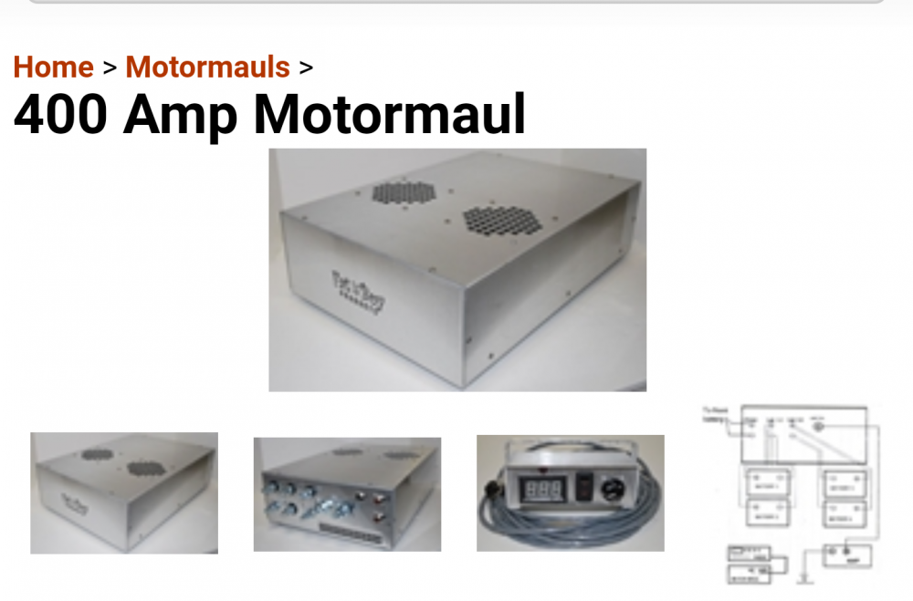

Seeking some knowledge on a new topic not previously discussed.Been trying to find a fabricator or shop to manufacture a dual alt bracket for a 06 pathfinder and cant seem to find a brackets being sold or manufactured, but was told by an older experienced competitor than i can instal a ignition switch activated motormaul which is just like an alternator. From what i read its used by the CB guys to power their rigs. Fatboy products carry these motormauls ,can someone shed some light on this and if it would work for this application.Some background,i currently have an Ohio Gen 325 amp alt installed and would like this 2nd alt or motormaul to charge 3 80ah jy in the rear.
You can't get something for nothing. All this does is take a few batteries and put them in series when the cb mike is keyed. It is adjustable from 12 to 14v and basically gives a higher voltage to the amp for brief periods when transmitting. Might be ok for burps but is not something that can run continuously because it has to charge the batteries that are hooked to it.
