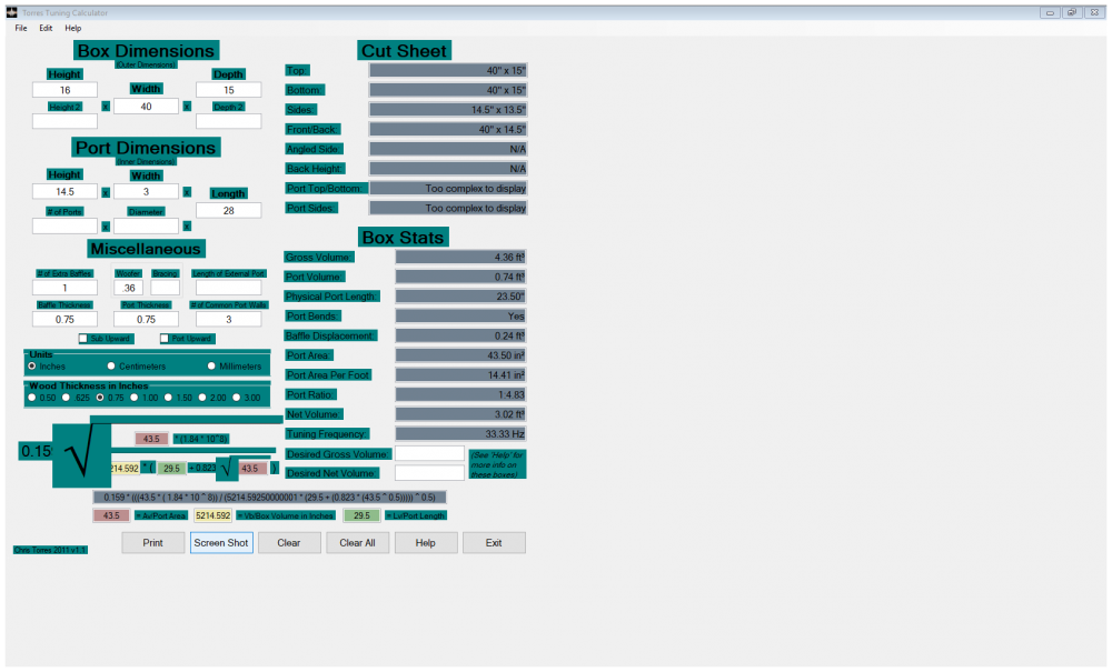

JumpinBean23 Posted November 18, 2017 Author Report Posted November 18, 2017 Alright after playing around with some ideas, I think I will end up doing a slot port. This is one of several I have come up with. Should be better on port area. Any thoughts or recommendations?
