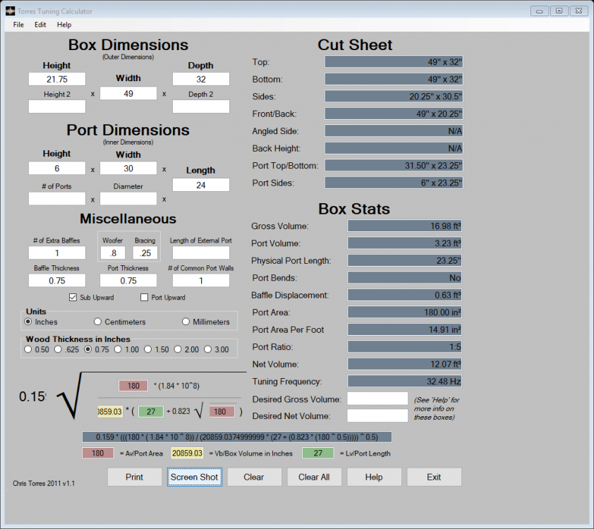

CRich614 Posted December 16, 2017 Report Posted December 16, 2017 Trying this again, looking for a new box. The space I have in the back is 34Dx49Wx24H probably can go higher on the height, this is just to the top of the seat, was easier to measure. Here is what I got from the website for the speakers. Skar Audio EVL-15 D2 15" Dual 2 Ohm RMS Power: 1,250 Watts Peak Power: 2,500 Watts Voice Coil Size: 3" Frequency Response: 15-250 Hz Sensitivity: 86.2 dB Fs: 35 Hz Re: 1.8 Ohms Qms: 4.60 Qes: 0.73 Qts: 0.63 Mms: 386.6 g Cms: 0.053 mm/N Bl: 21.0 n/a Vas: 46.0 L Sd: 779.3 cm^2 Xmax: 24mm (one-way)
Triticum Agricolam Posted December 16, 2017 Report Posted December 16, 2017 How much power are you running? "Nothing prevents people from knowing the truth more than the belief they already know it.""Making bass is easy, making music is the hard part."Builds:
CRich614 Posted December 17, 2017 Author Report Posted December 17, 2017 I have a 5000 watt amp right now.
Triticum Agricolam Posted December 17, 2017 Report Posted December 17, 2017 Here is a suggestion: "Nothing prevents people from knowing the truth more than the belief they already know it.""Making bass is easy, making music is the hard part."Builds:
