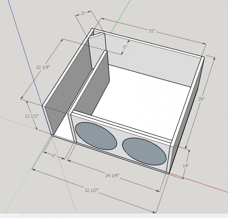

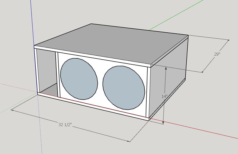

OK, here is how I would do it:
The port panel runs all the way until its 6" from the back panel.
This should leave you with about 4.3 cu ft net of airspace tuned to 31 Hz.
