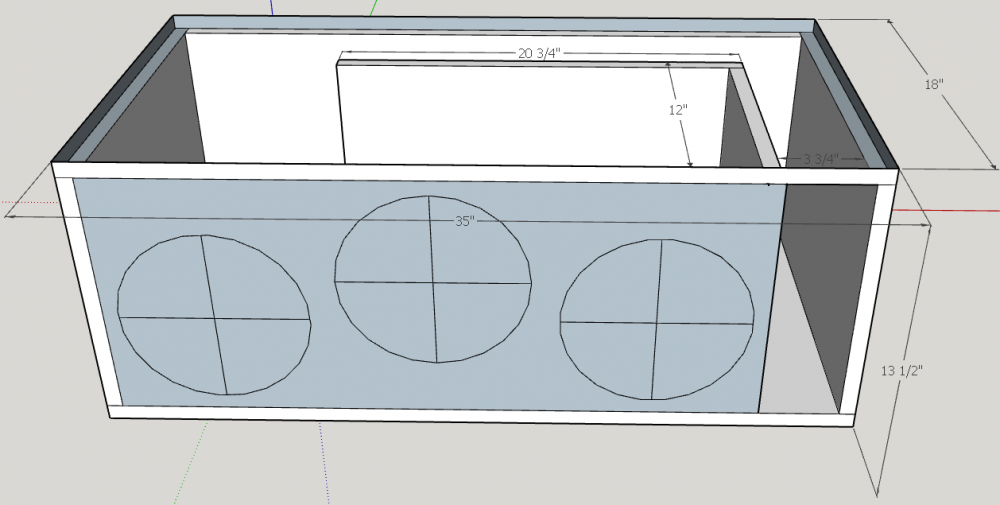

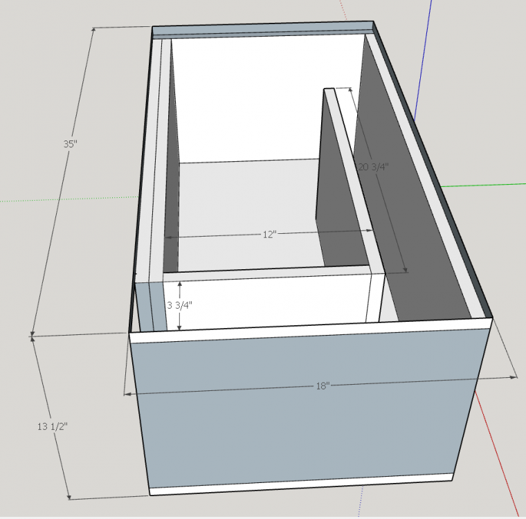

godlyforce Posted April 23, 2018 Author Report Posted April 23, 2018 On 4/20/2018 at 7:01 PM, Joe X said: Mounting subs in different faces is usually avoided but then you can always try and either win or lose the bet, what's probably more important is that you meet the 45 square inches of port area, if not close to that your port is likely going to choke and that for sure is not going to help you. thanks for the help i done decided it wasnt worth it to cut a hole and mess with the old box. im just going to build a new box but im not very optimistic about my design measurements. can you give a quick look at this design and see if it is within the specs im shooting for? I THINK this box is around 3.8 gross and 2.6net and trying for around 35hz tune. port is as you suggested and is 45 sq.in. All with 3/4 mdf. would love some input as i have never designed a box before i have built a few but never designed.
Joe X Posted April 23, 2018 Report Posted April 23, 2018 That is [email protected] with 45 sqin of port area as stated, gross is 3.66 cubic feet. That is about 0.75 net per driver, As long as you have port clearance of 3.75" on the outside that box looks like a go to me.

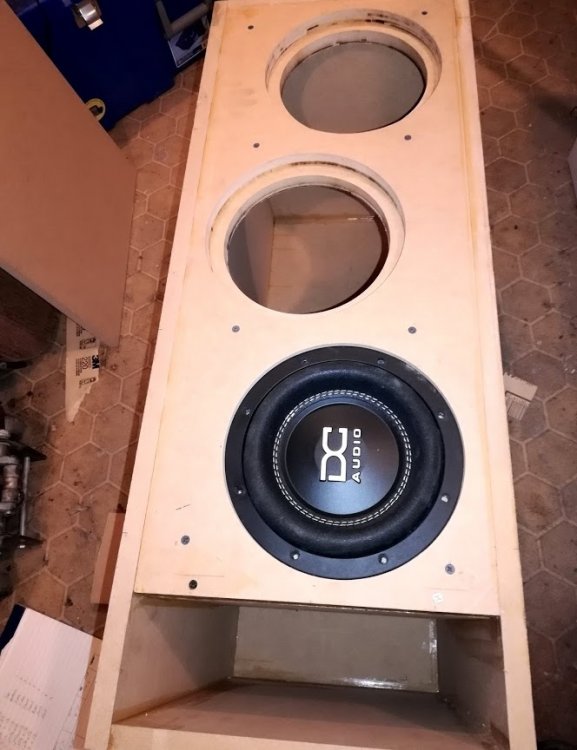

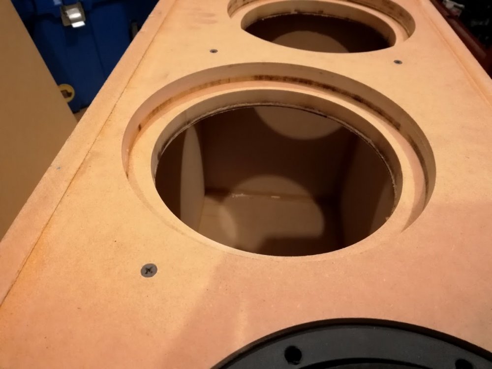

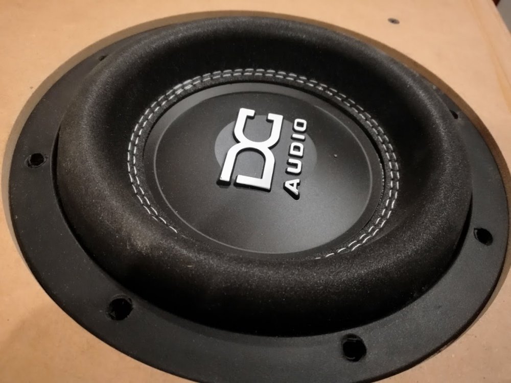

godlyforce Posted April 24, 2018 Author Report Posted April 24, 2018 Built it and it sounds great. you can see some burning from the router bit as i didnt have a good bit and trying to cut more than about 1/8" at a time would burn the wood so funny enough cutting 6 holes took nearly 2 hours. also funny enough i had to sand a little after it was completly built on the outer baffle cutout as it was too perfectly tight and i knew it would be nearly impossible to get the speaker back out even now its still very snug and am sure i will need to cut the box open to remove the speakers...
Joe X Posted April 25, 2018 Report Posted April 25, 2018 Looks very nicely built bet you build pretty often, never mind your subs being so tightly fit, there will be many ways to get them out without touching your box, worst case you drill a hole on the back of the box on the left side (beyond the end of the port wall) and use something to push that sub out, once that one is out it's easy to get the others out.
