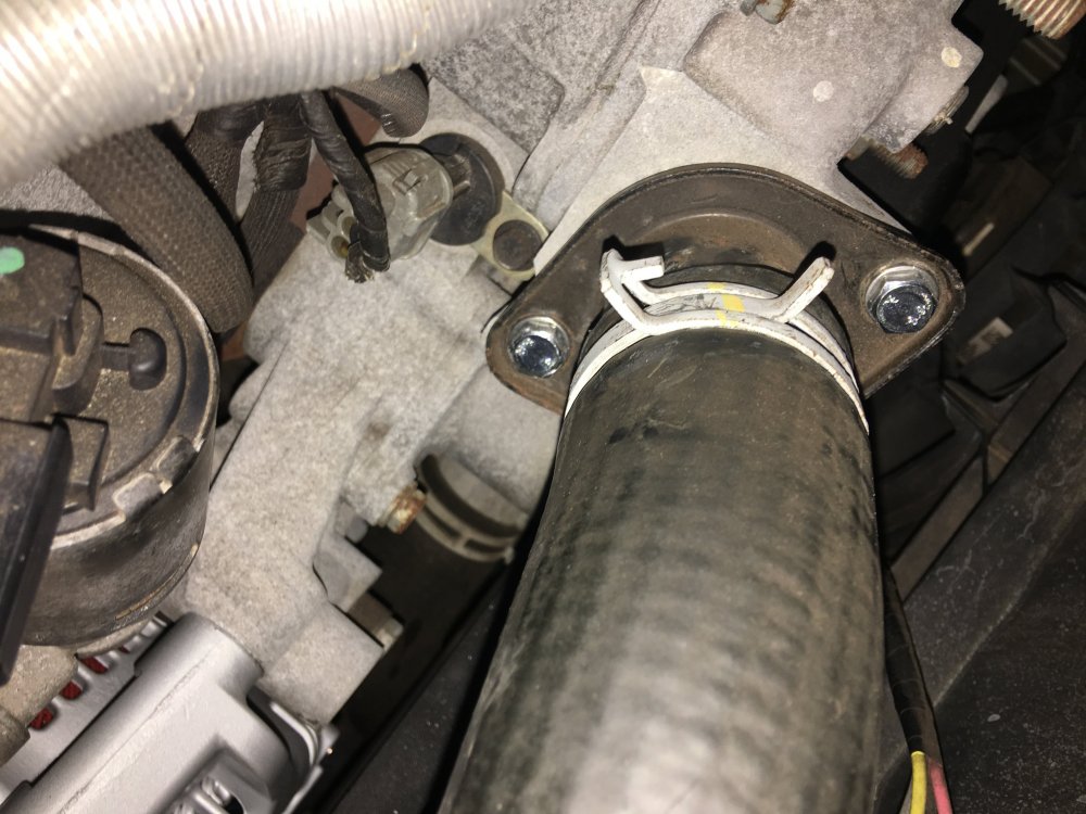

I guess I'm lost why you didn't remove the hose at the clamp!?!?
I tried that first. I was able to get the bottom clamp off and easily slide the hose off. But that top hose wouldnt come lose after i unclamped it. And i didnt want to test if the hose was brittle and rips on me, figure just take the two bolts off would be easier. Failed lol
 So far I think the best bet sounds like using an extractor bit like u showed, to get it out successfully. So ill just skip to that method and pick some of those up.
4 hours ago, mathewyocham said:
You could always drill it out and retap the hole.
Thats too advanced for me.
2 hours ago, Crazy 8s Drums said:
That looks like the thermostat housing.  If so, just replace the housing.  Shouldn't cost more than 20 or 30 bucks.
If i cant get this out with the extraction bit then ill see if i can replace it.

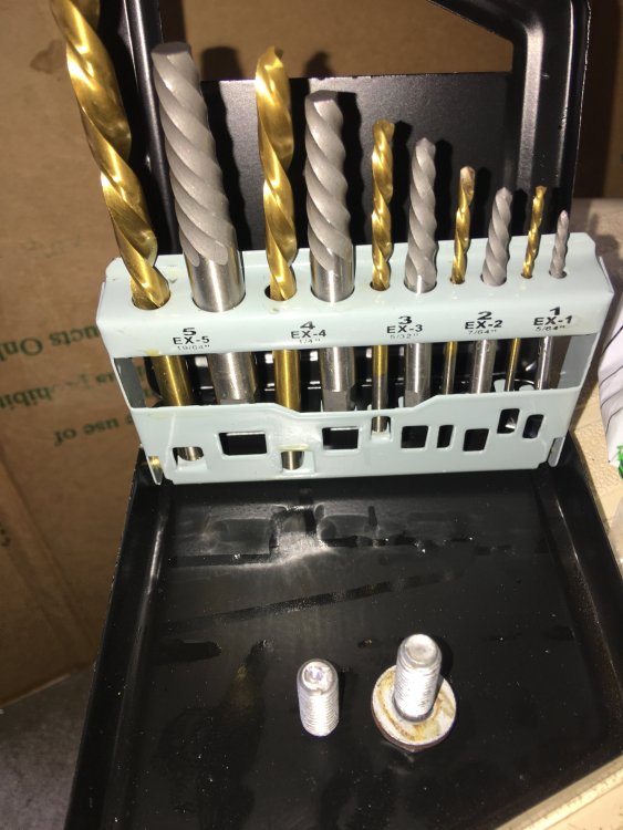

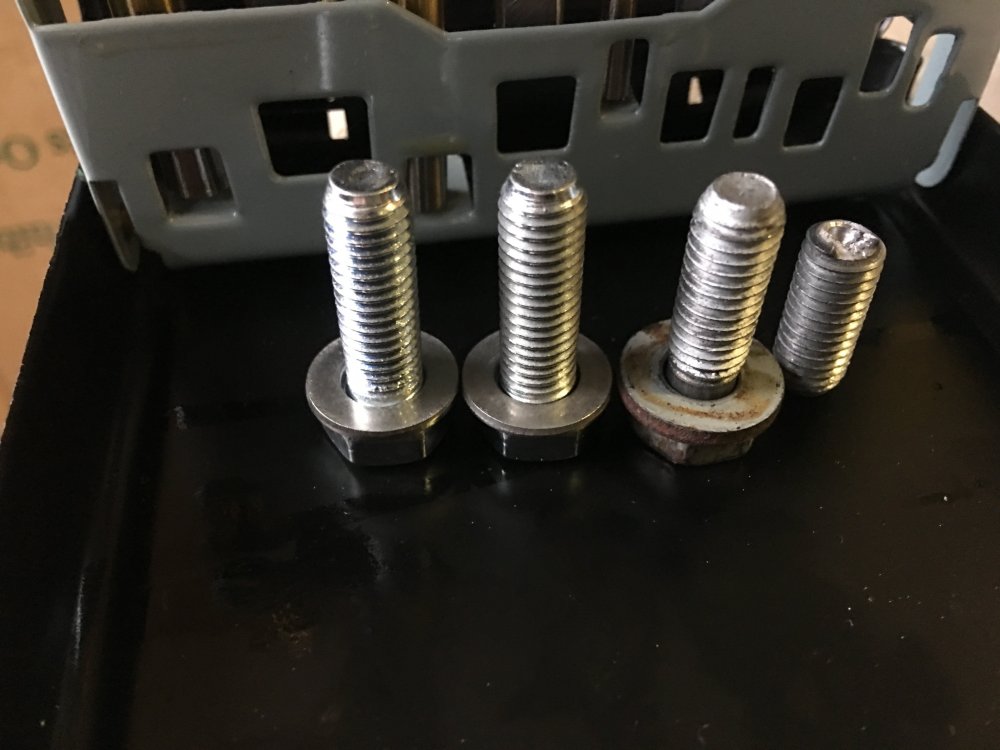

Finally got to that bolt. Bought a kit that includes reverse drill bits and the extractors. Didnt even need to use the extractor bit, the bolt started to move just when i was drilling the hole for the extractor.
Got two new bolts from Ace Hardware.
Replaced bolts and reinstalled hose
