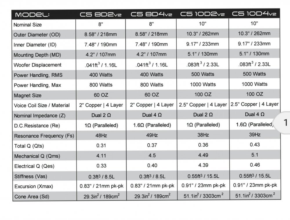

lawrenq Posted August 6, 2018 Author Report Posted August 6, 2018 Yes, here it is, I have the 10d4v2, I can build a bigger box than the one pictured, but I like the idea of having the port coming through the deck like that.
