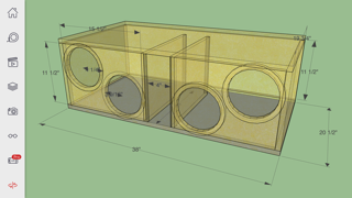

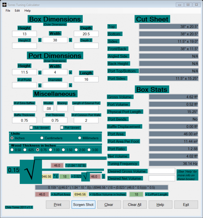

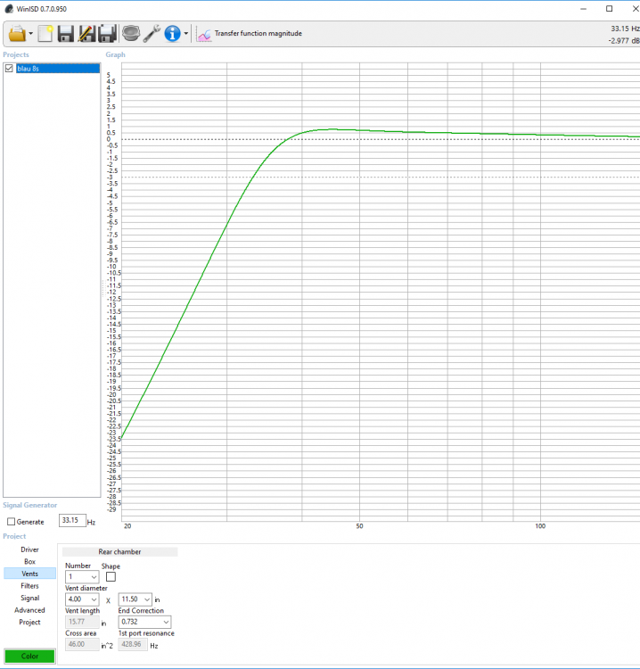

I modeled it in WinISD and to me it looks best at 4 cubes net tuned to 36 Hz.  With this port area the rear port velocity in under 30m/s

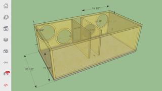

Here's the design in Sketchup w/the Torres Box calc sheet.
https://3dwarehouse.sketchup.com/model/8797cd6d-03df-46ad-b458-8bfa803b2561/four-8-subwoofers-in-4-net-cubes-at-36-Hz-wTorres-Calc-sheet
and w/o the Torres:
https://3dwarehouse.sketchup.com/model/752376f8-6513-48bb-a0f9-408b049d1d41/Four-8-subwoofers-box-in-4-cubes-tuned-to-36-Hz
