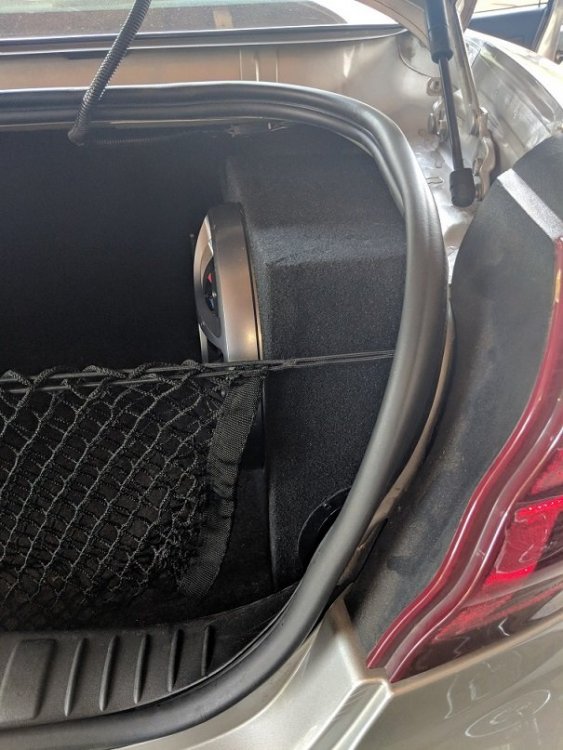

CorNut Posted August 10, 2018 Author Report Posted August 10, 2018 Here's the finished product, it sounds great for being a single 10
